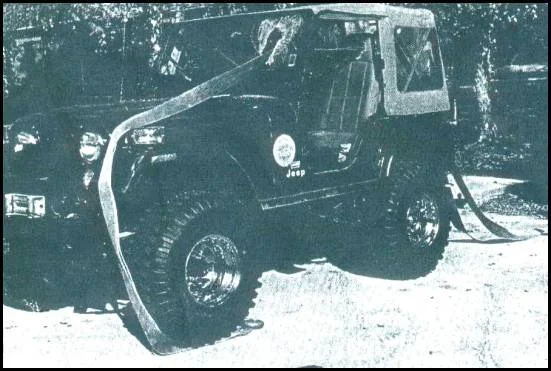

I found an article on that accident. The bumper on the other vehicle broke. The guy was grazed be the shackle and knocked out. He had to be taken off in a helicopter. The jolt of the break of the other bumper saved his life. He's head went forward out of the direct path.
I have been using chains after seeing that pic.

Quote:
Originally Posted by greytandy
One end is easy since you can loop the strap through it's own loop, but the other end?
Looping the strap through its own loop could make it very hard to untie if the pulling forces make it tight.

When chains snap they do a lot more damage than that pic..
I HATE using chains...

Quote:
Ok, so your saying chains stretch?

Chains will break of course but I've never broke one or seen one break. They are very unforgiving if the hooks are attached wrong or attached to "flimsy" metal. I personally wouldn't use a chain of less than 70 grade and they aren't cheap. IMO Straps with shackles are far easier to use, cheaper and usually cause less damage if secured in an "unconventional" manner.

[quote=WES1977
I have been using chains after seeing that pic.[/QUOTE]
Chains? *Maybe* for towing people, not freeing mired rigs from mudholes. A chain does not serve the same purpose as a recovery stap. No stretch, no storing of energy and no shock moderation. Even a gentle yank with a chain will snap the chain or rip the attachment point off the rig. I won't even use one to tow beyond moving a rig around in the driveway.
Chains are great for rigging winch cables to boulder for an anchor, or for attaching a cable or stap to a rig with no recovery points. Other than that they have no place in vehicle recoveries.

And yep, chains do stetch. Not to the degree that a strap does, but enough to make it jump pretty good when a link snaps.
A chain by itself will not propell itself through a rig the way the trailerball/shackle on the end of the strap did in the picture above. It an certainly give you a good whack if you are standing beside it when it lets go. Chains do'nt normally have the damage potential that a strp WITH A CHUNK OF STEEL STILL ATTACHED does. A strap by itself is not all that bad either. It doesn't have enough mass to cause a lot of damage and the drag of the air slows it quickly as well (again do to the lack of mass).
The bad situations are not usually caused by straps or chains them breaking. They are caused by the attachment points breaking off of the rig when the strap yanks on them. Then you get all the energy of a strap with a weight on the end. Attaching a chain to a strap is a problem if the chain is rigged so that it can come flying back with the strap pulling it if it breaks. The only way I use a chain and a strap together is when the chain is wrapped multiple times around a frame, axle,bumper or whatever. That way if a link does break, the chain doesn't come flying free of the rig on the end of the strap.

What about hooks on the end of straps???
I posted a pic of one of my "ropes" with hooks but didn't get any answers on why it was more dangerous then shackles...Is it just the potential of that hook coming off?

thats why you place a blanket over the strap after you place tension on it BEFORE you start to pull....that way IF it breaks, the weight of the blanket will prevent it from becoming a whip.....a cheap 9 or 10 dollar furniture blanket from uhaul, wally word...ect is the best....serves dual purpose should you get stuck somewhere and its cold......
