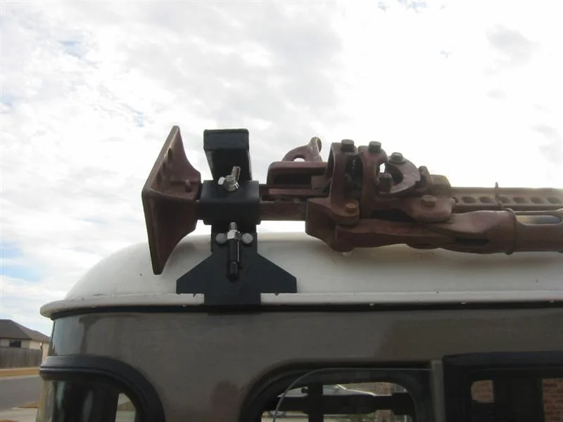

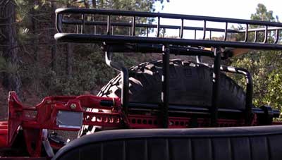

I just pulled mine from the front bumper and mounted it to my rack like this.

Posts: 1,595
I like the creative set-up, HawkDriver. Looks nice.

Thanks,
Being that it's a 60 incher, I had it on my front bumper but when I built the smaller 46" bumper in the avatar I needed to move it. I think I'd rather it be in the back by the tire carrier, but this works for now. I kind of think it looks cool up there, but I kind of don't. It was super easy though, I just welded the bolt to the bracket and slipped it on.

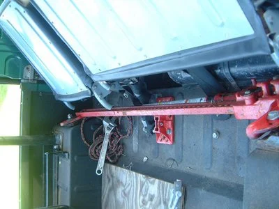

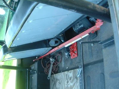

Here are the pics...
As you can see, the High-Lift does not take much cargo room and is slightly off the bed floor:

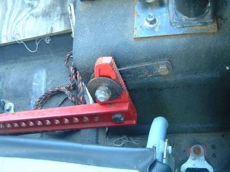

the drivers side bracket has a bolt that aids in re-securing the High-Lift when you are done.

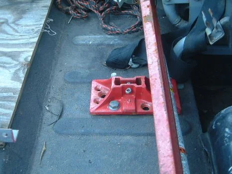

the passenger side bracket has a nut, and the bolt has some left over bushing material to eliminate any unwanted vibrations:

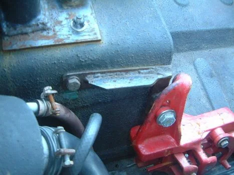

The base is easily removed/re-attached by pulling the original pin, and is secured 1/4" off the floor.
The other thing I like about my brackets is that they utilize EXISTING threaded holes in my 40.
No drilling required and Rubithon tested

Since my seats fold out of the way, I am still able to get to the Lift w/a bed full of gear.
2 bolts, 1 nut and a pin and your ready to go.
It's also out of harms way, how many bent High-Lifts have you seen?

If you look at mine above it's bent, but that's not from being stored anywhere, it happened during use. And unfortunately when you have a big jack you gotta find somewhere to store it outside.

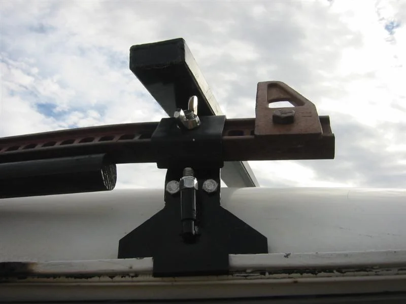

I did a very similar setup to Posers above. I took off the base and fashioned some mounts (Home Depot style like some of my other posts on making my own pieces) and attached the jack to a rear rack just behind the center mounted spare tire. I also made some home-made rubber shock absorbers to mellow out any up and down motion. I added a rifle gun lock to lock it to the rack.
