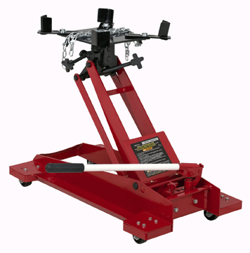

Any thoughts on this 800# tranny jack?
http://www.harborfreight.com/cpi/cta...temnumber=3185

I have a 'nice' tranny jack....do not like it. Plate style. similar to what you have pictured, allows movement/rocking of the unit on the jack, read not very stable...least not what I like.
The hoist is far more useful.

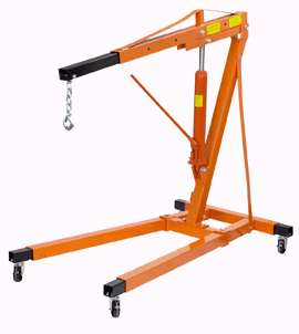

This one is $200 for a 2 TON CRANE

Here you go Max. Go with a folding model to save space (they spend most of their time not being used). The first one includes a leveler. However, you can find these locally and save the shipping.
http://www2.northerntool.com/product-1/200305213.htm
http://www2.northerntool.com/product-1/200317240.htm

I have one of the cheaper unit hoists. I use it for all kinds of things, it is a great shop tool. I spent around 150, but it was on sale.
It is a 2 ton unit.
I would only add, get the kind that the legs fold up saving a TON of space when it comes time to store it.

I have the 8 ton folding Harbor Frieght hoist that looks much like the one you pictured, Max, and it's been great for over two years. Think it was on sale at $149.99 or so. When folded up, which only involves raising the forward legs, it only uses some 3' x 3' of floor space - parks out of the way really well. I took all of my machine tools off of my trailer with it and put them in place using that hoist and they run 1200# up to 2400#.
See if there's a HF nearby. They're putting stores all over the place.

The HF folding hoists are pretty good actually, I've used the 6 caster model specifically - surprisingly one of HF's better tool buys. The 5 ton roll around floor jack is also surprisingly good. I've been using both of these tools for about 2 years now while I "store" them for a friend
The hoist is more versatile for more things, you can upgrade to an air operated lift cylinder(very handy) and beef it up as you see fit if the need arises. I don't care for tranny jacks, I do like to make plate adapters that fit onto the roll around jack specific to each tranny, diff, Tcase, etc...that seems to be the best method I have found.
For the first time ever, I would suggest buying HF junk and getting both - I have never reccommended HF junk before but for your purpose and not full-time shop use, these are pretty good. Just get both and you'll be set. Sell whichever you don't want to keep or sell both when the job is through, they won't loose much value...they don't have much to begin with
