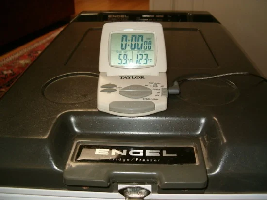

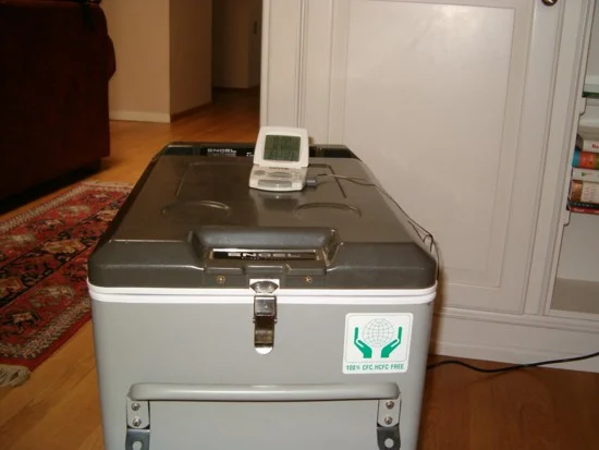

Experimental Set-up
Ok-I'm giving into the madness. Here are a few pic of my now more scientific fridge test. I have a thermometer with a remote digital read out. The tip is in 500ml of water. At 3pm it was 68 degrees F. It seems to be cooling fairly quickly. The fridge interior started at warm ambient and was 29 degrees F after about 20 minutes. edit-this is the 45 quart version of the fridge.
Initial data points (water temp):
3:00 68F
3:30 64F
4:00 53F
4:15 48F
4:30 42F
Went to Borders
5:30 33F
5:45 32F Ice Forming, experiment ended.
Eric-arn't you an engineer? You should have all sorts of gadgets for gathering this sort of info, but it won't change the basic fact that you need an Engel fridge. Propane fridges suck in comparison.

errr.... 123F is not freezing, you know!
and why did you stop, pray tell, we wanted to see how long it'd take to freeze over...

123F was the temp the thermometer was set to beep last time we cooked a rib roast! I ended the experiment because it was 32 and had iced over. I cleaned it all up at 6pm and the temp probe was frozen into the water, but not solidly.
It looks like Ben's data is proving the same thing. THese fridges cool fast and well. When I opened up to end the experiment the air temp was not readable with my food thermometer-I think it can only read to 15F. That's pretty outstanding performance for a device this efficient that can go with you anywhere.
If the spirit moves me, I'll repeat the experiment with 1000ml of water starting from ambient, then a whole fridge full of cans of beverages starting from ambient.
wow! so at 3pm it was ambient and at 6 it was close to having almost fully frozen a qt of water?
that is really good indeed!
there is indeed a big difference between these and my (maybe all) absorption device. No comparison!
