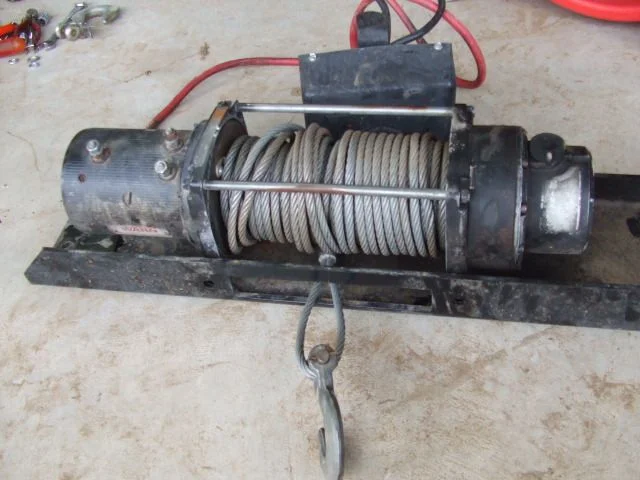

Hey I have an ancient old warn winch, I don't know what it is but it's REALLY old, it's 6000lb.
The motor works great, but the electrics that control it have kind of had it... I had it going a while ago, but now it pretty much just makes weird noises at me. Is there a simple way to just get a new control box for it... like a generic one? I mean all it does is switch the current polarity right?

Is it power in/out? Electric brake? Can you post a pic?

uh yeah one sec...

Does it kinda resemble the 8274 winch?

here we go... sorry for the size and weird angles, i'm at an internet cafe with my camera

Looks like a old M6000 winch. I bought one new in 1988 and just traded it to a jeep owner for his 8274.
The plastic engage/disengage lever is NLA. If that breaks you will have to buy the entire end cover and the metal lever.
