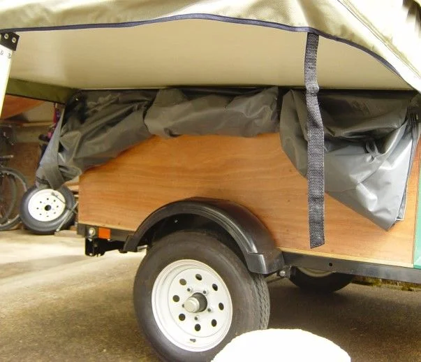

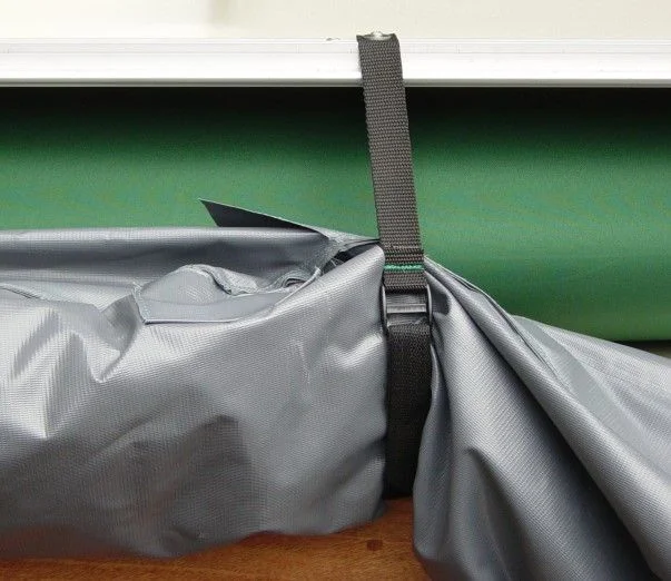

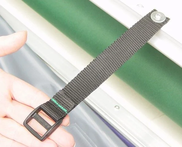

Hold up your Mombasa travel cover
It’s a little thing but having the travel cover on Mombasa RTTs just hanging there when off, has always bugged me. Here is the solution I came up with. It’s a strap with a loop on the end attached to the tent’s perimeter frame. The looped end is attached to the travel cover’s anti-ballooning strap. The straps are 8" long and attached them with #8 – 1” self tapping screws
