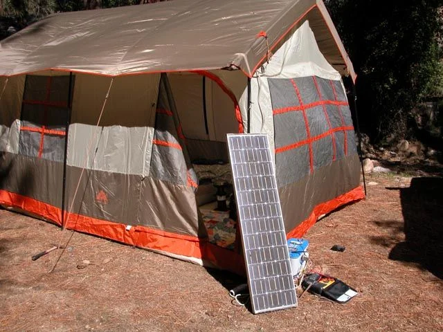

Gentlemen BEHOLD!
Optima group 31 blue top, SunSaver charge controller, Arco panel and a meter to see what's going on.
