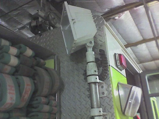

That's kinda how our scene lights on fire trucks work, except they don't have a storage tube for the curly cord. Cell phone snap:
