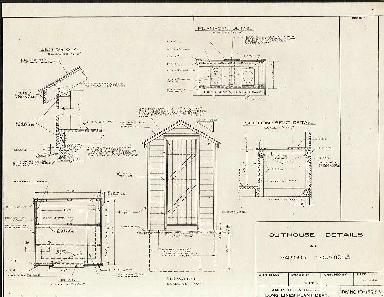

this may help. Good enough for ma bell:

ideas
I was impressed someone was able to find AT&T's old plans!
Where I live, far more people live w/o indoor plumbing than with. Here in Bush Alaska, unless you live in an Indian village, most of us make use of outhouses.
The Traditional Chief of the native community closest to where I live, about 80 miles away, had one pithy remark that I can recall: "White man crazy: S**t in house" He didn't talk that goofy movie-indian talk at other times, but he did then!
And, as you can imagine, it also gets a tad cool here. There is nothing so scrotum-shrinking as to have to sit on a wooden seat at 40 below.
Unless it's at 50 below.
So what we do is forego use of a standard toilet seat, and line the platform instead with rigid insulation. Some swear that blueboard is the comfiest; others have to use pinkboard. Sorry - they're identical, as far as my cheeks are concerned. Either color is terrific on the fundament.
