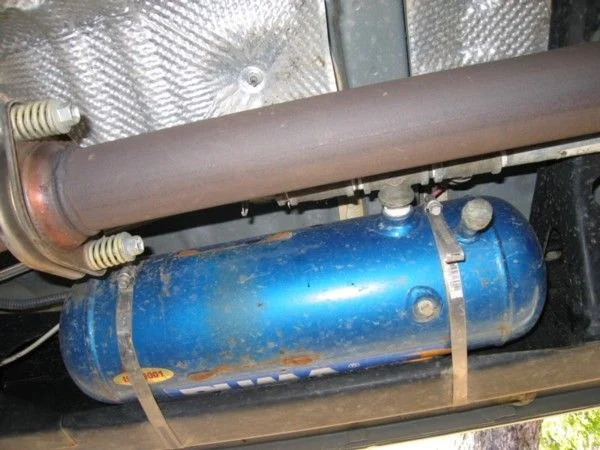

Hello, I am new here but really like the site.I have had this compressor for almost three years . For the first 1.5 yrs I used it as a complete unit as shown above, when I bought the Tacoma I took it apart and used the pieces for my oba system and it really works great! I use it a lot for tires, mine as well as everyone else's. Used it for small nailgun jobs, impact gun , blowing out the cab, filling air mattresses and much more. It kicks butt for the price.

I plan on divorcing nine, mounting the pump in the rear cargo area and the tank underneath. Are the threaded fittings all standard, easily available sizes, it looks like you used regular plumbing fittings? Where did you put the head unloader valve and pressure switch?

Thanks, The fittings are all standard Pipe sizes . The unloader is the first thing out of the head I used a small inline one I found at Grainger. I can look it up if you want. Pressure switch is at the tank along with the check valve inlet.
