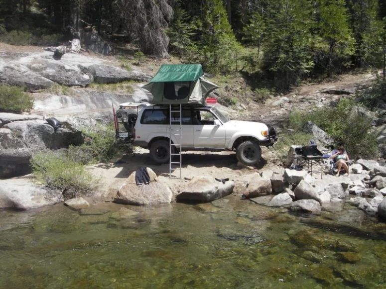

Here is my solution. I bought the new model.
Agreed, really nice rig, I wonder who's that might be
I've considered the new model, but it seems as though there is a significant weight and packed height difference between the two. I think with a proper light-weight rainfly on the older model it will make for a really nice light duty set-up.

Being the one who lifted both of them, the weight difference is nada.
Maybe 5 - 10 lbs. I actually got the Expedition one up on my rig by myself with only one little scratch to the paint...(and a hernia).
However, the pack height is about 4" taller which I don't like but I plan on putting a different rack up there and the smaller length gives me 20 extra inches.
There are aspects about the old one I like better, one being the excessive room inside. Very cool, but a better fly would have been nice.
In my opinion, they are both very functional platforms. You don't have to drop $1800 to sleep on top of your vehicle in comfort.

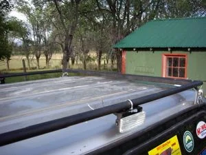

Nate what roof rack are you running? if your concerned about the hight of the tent off the roof when closed you may consider running a different rack? I welded up a simple cross bar with tube sides for my rack using the quck clamps ive had forever. I had to remove the factory rack (junk anyways) and now the tent sits just off the roof. ill prob be getting rid of the rack when the tent comes down to the trailer which is the next big project.
I'm using Yakima feet and crossbars, so it does sit pretty low, but let me know when you want to get rid of your current rack, looks slick, I could be interested.

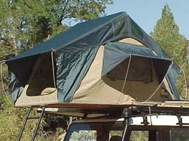

Looks like a great plan. Are you going to take the entire tent apart to sew everything up?
No I'm building the fly separate from the tent. If you look at the attached image you will get the idea of what my rain fly will look like. The only exception is that my side window awnings will be part of the rainfly not part of the tent.

Quote:
Originally Posted by zjz4476 View Post
Skillet,
Can you take some pictures of you new model tent for me without the rain fly on it to show how the exterior extentions are attached to keep the rain fly up and off of the tent? Some close ups would be nice.
Thanks
Zane
Zane,
The rain fly on my new model does not come off. You can tuck it up out of the way but it stays put.
I can take some pics of how it attaches though, if you would like.
Let me know.
Jeb

Jeb,
If there is a way to take a picture of how the supports are attached/designed so to keep a gap between the tent and the fly that would be great! I have some idea's of how to do this, but would like to get a better understanding as to if the bars go through the main tent fabric and attach inside the tent to support the fly or if the are attached somehow from the outside.
Any help would be appriciated!
Thanks
Zane
Quote:
Originally Posted by Skillet View Post
Zane,
Let me know.
Jeb

PROJECT UPDATE:
Ok so I have recieved all of my fabric, thread, webbing, clips and sealer needed to start pulling together my new rainfly.
I wanted to provide you with a materials list to help anyone out who is thinking about doing this themselves.
Material and Misc purshased from www.seatlefabrics.com
10 yards of Super K-Kote Ripstop 140 Denier w/ 1.5 oz pvc coating in Olive Green @ 9.50 a yard
Seam Grip Seam Sealer 1 oz tube @ 6.95
#46 Nylon Thread Black 1 oz spool 5.49
Hardware items purchased from www.strapworks.com
50 feet of Lightweight Polypropylene 1 inch webbing @ .15 a foot
8 Acetyl Plastic 1" Footman Loops @ .65 per
8 Acetyl Plastic 1" strap adjusters @ .45 per
I have cut the first main section last night and hope to get into the details over the weekend. Will post things up as it all comes together.
Zane
