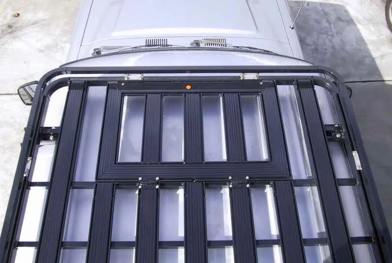

Pic's: African Outback Rack on Fj60

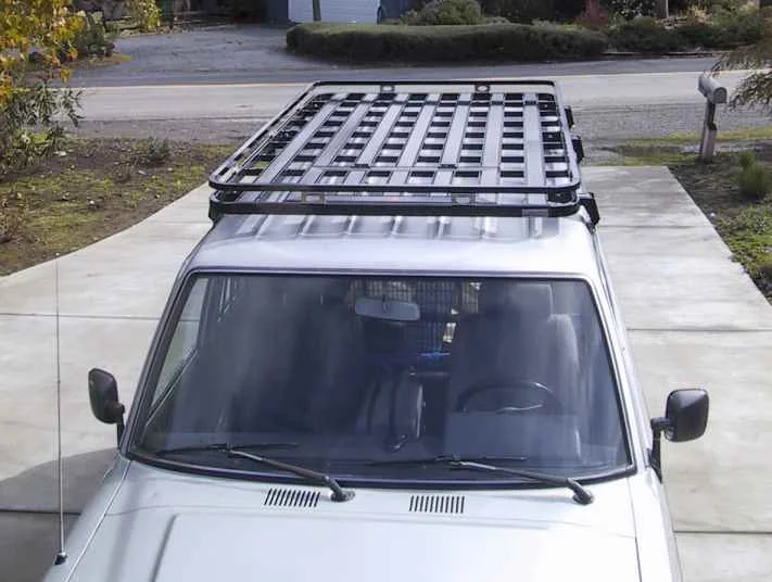

this is just a teaser for now. I received a big cardboard box this week from Colorado that contains a full length african outback rack for my Fj60. I'll be doing the install this weekend. I'll be taking some pic's for posting. If anybody want's to see something special, while it's still in pieces, let me know. So far, with all the pieces scattered on my dining room table, it looks like it's going to be sweet!
Edit: Here are some pics of the competed rack. More pics below...The rack is really nice and solid. It's light, too. I can put it on top by myself. My only complaint is that to get the mount width correct for the rain gutters, the rack is not centered right to left. It sit's about 1inch off center, although you can't really tell...

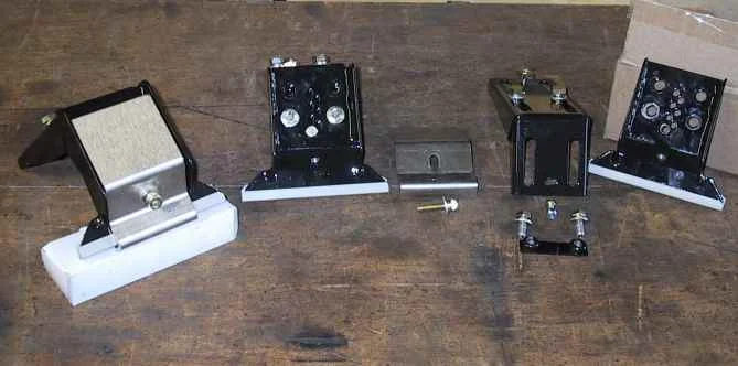

The first picture are the gutter mounts. these adjust in height, and mount on the rack to allow adjustment of width. I set the height at the lowest setting for my FJ-60.

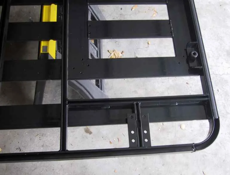

The second picture shows the mounting plate on the rack for the gutter mount. Nice and solid. You can also see one of the two knobs that secures the trap door that sits above the sun roof (for the 80 series).

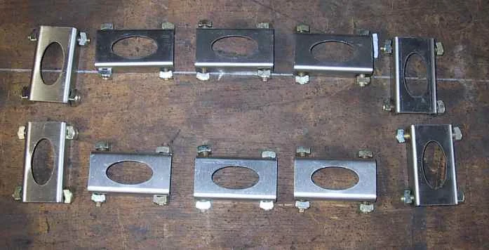

The third picture is a close up of the brackets that hold the top rail on. It looks like 3/16" stainless steel.

Here's one more picture looking from the back.

The floor of the rack measures 51" wide x 82 1/2" long, outside edge to outside edge. The rail is about 1" wide.
measuring height, but sticking a ruler in the bottom of the rain gutter, the floor of the rack is 6 1/4" high. The top of the rail measures 8 7/8" high.
