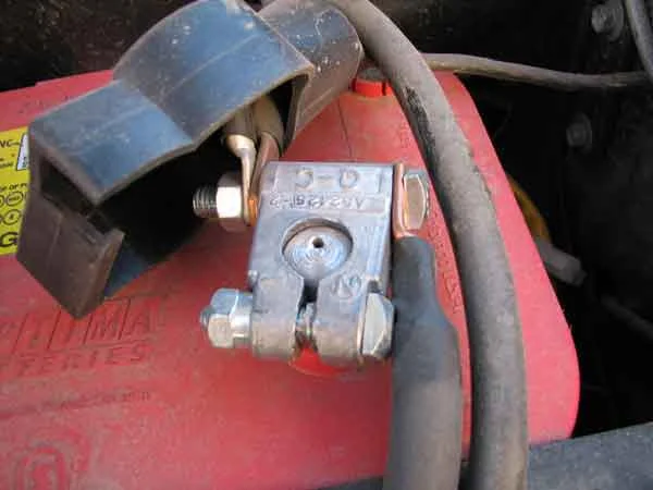

Here is what I have installed
I've not seen that before. What's it called and where do you buy those multi-gang plastic doohickies?

Red and black terminals and the add ons. And for those that don't like lead terminals, West Marine has military style tinned copper.
