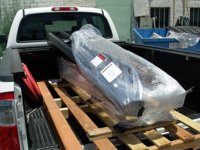

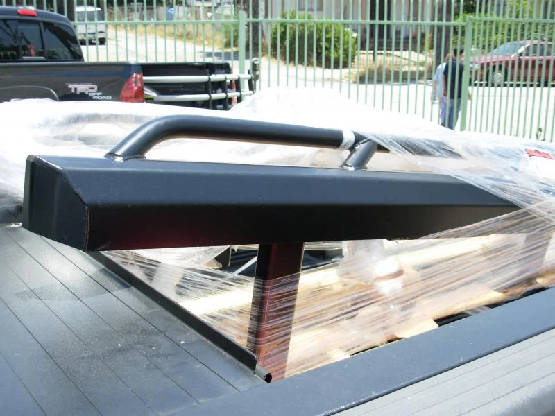

Look what the freight company dropped off
Such great service from the guys at Metaltech. I ordered these wednesday and they showed up today.
The guys told me that i need to remove the heatshield above the cats to install these. Also, i need to move the fuel line on the drivers side to insert the U bolts. I think im going to attach the fuel line brackets with thicker rubber washers, i do not feel comfortable leaving them with the stock screws.
Does anyone have any experience installing these ? Any tips would be appreciated.
Ill post some pics once they are on.
Harry
