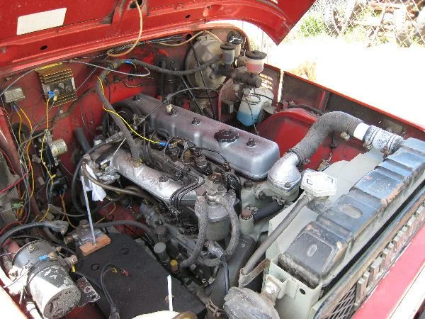

Grants Pass is not too far & if you ever head over to the coast ?
i have a 40 with an old H1 in it in Crescent City
they are (almost) a bolt up :-)
you are welcome to see it, just give me advance notice
i'm not a purest so with the 350 already in it, i would think the Vortec would be your easiest swap
here is my H1
