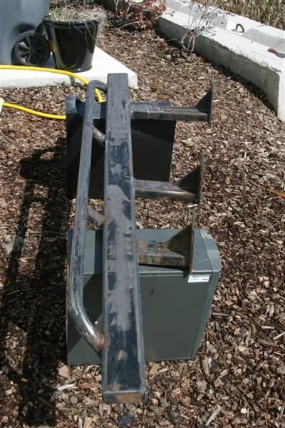

Well, got my sliders in last night. I was going to slap them on, but decided knowing me i would never get around to taking them off to repaint. Since they got here a week earlier decided to bite the bullet and strip them down and paint. Countdown is on till McGrew!

That's one use for old boxes.
How far are you stripping down? Just wire wheel on the rusty parts, or are you going to try and get to bare metal all over?
Don't leave them outside overnight. They might disappear. (Though they'd show back up after the pre-run. Probably.)

No powder coating that I can tell. I used a spray aircraft stripper stuff from Napa, 20mins later is pretty much what you see in the pic with a putty knife. Stuff pretty much just liquifies. Almost could just wipe it off with a rag. Im not concerned about the remaining paint that didnt come off. Just going to wire wheel the rusty spots, scuff/sand and primer then coat.
Ya great us for old box's  lol, and a ramped up my security system and camera's surronding the prerimeter! LOL, j/k.
EDIT: ya powder coating sucks to remove. The aircraft stripper stuff will eat through it, but takes a couple times, and is just nasty stuff. Wire brushing the "good" parts of the coating is futile. May see about having them sandblasted real quick.
