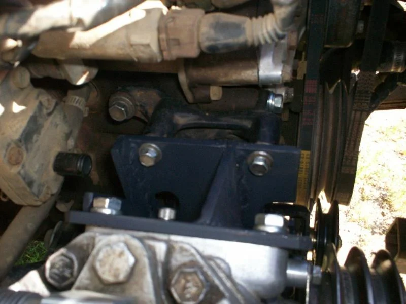

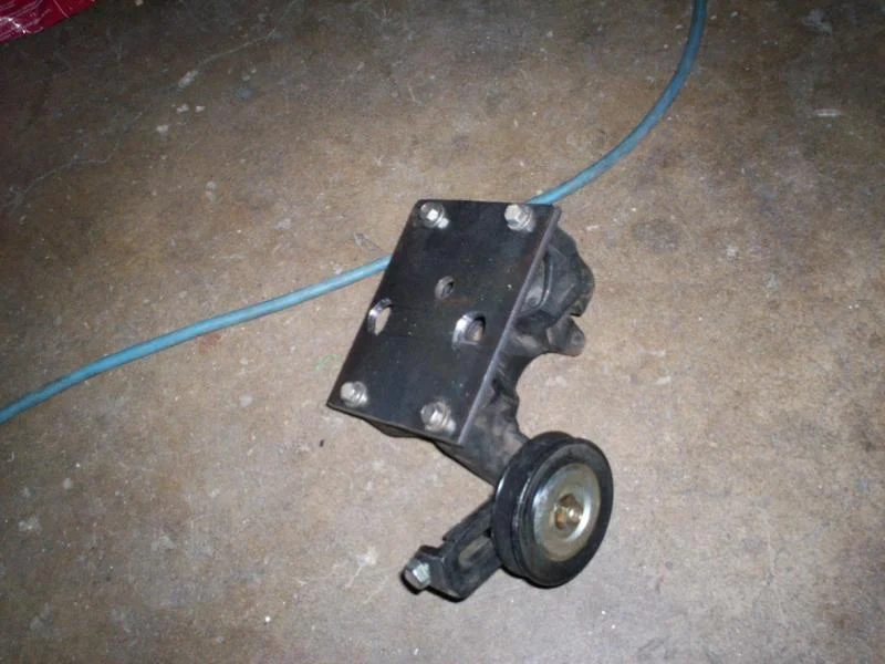

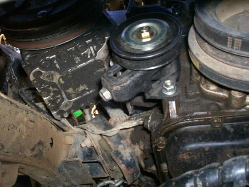

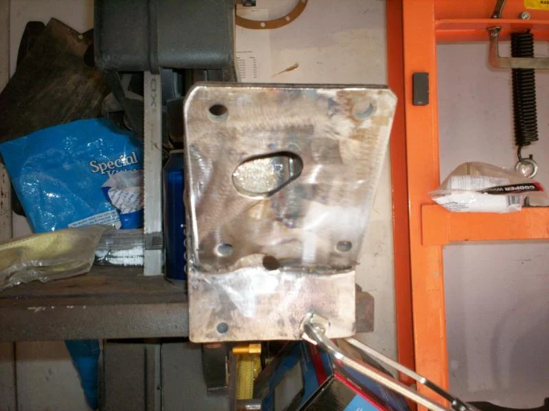

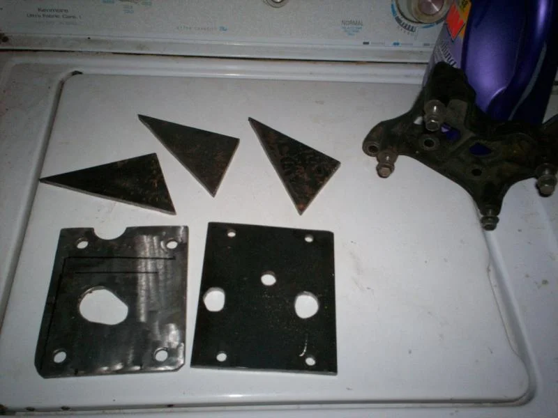

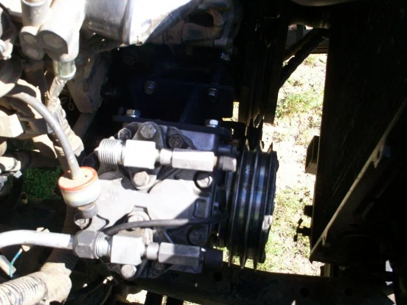

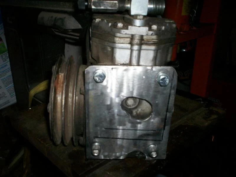

well every year leading up to mcgrew it seems that i am scrambling to get my mini ready to go. in fact i have been known to finish my "mods" actually at the trail head and on the trail. my list last year was the new bumper, paint job and hydro assit.
this year my mods consist of the final mods to fit the 42s, some sheetmetal cutting and pounding, i had to cut the rear bumper back from the tires. the new turn signals and finally this year i am mounting the york pump for OBA.
heres a couple pics from the york project.
these pics are some rough bracketry pics.

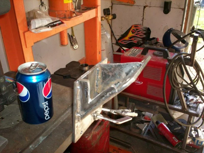

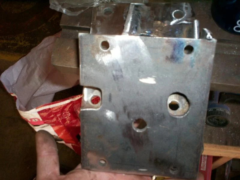

some finished bracket pics

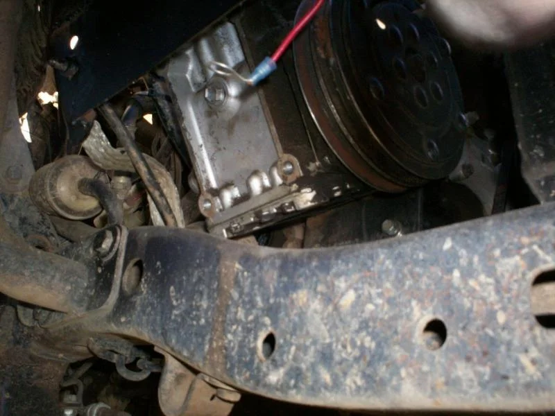

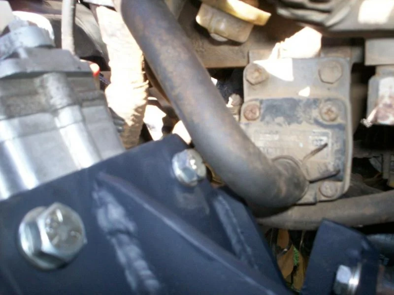

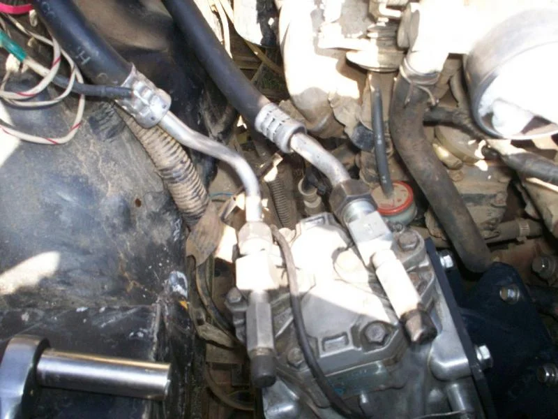

getting closer

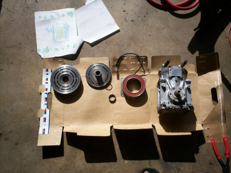

cleaned up the pump and parts
and on the truck

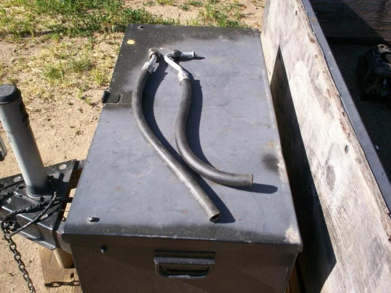

figuring out my hoses, these are stock yota A/C hoses that i kept from my runner.

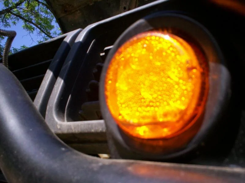

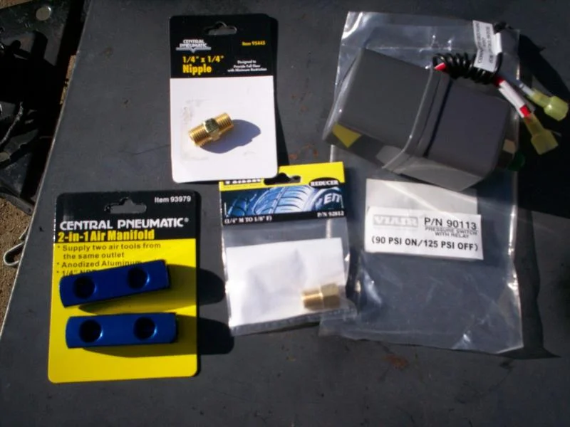

my pile o' plumbing.
those fucking harbor freight special LEDs full of water, weak i bought some new ones from withams truck stop, the new ones are "trucklites" brand, havent installed yet, but its only two minutes.

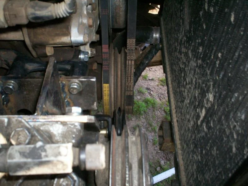

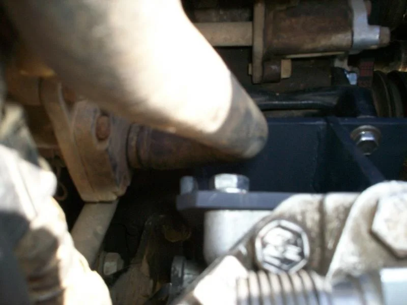

couple more showing the fit around the fast idle valve.
gnob is online now   Reply With Quote

just a couple more of the tight fit.

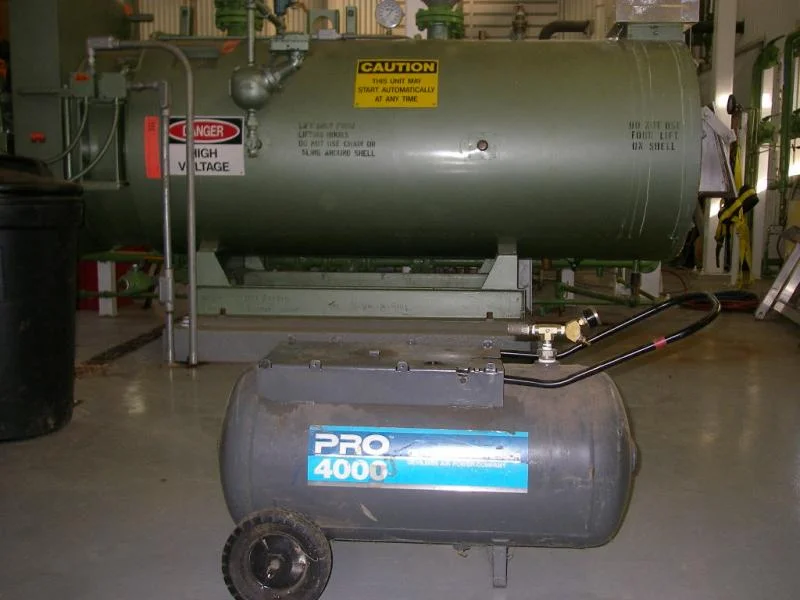

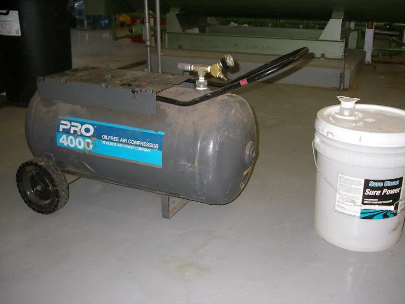

I got your air tank, it's bigger than you want, but the price is right; 0.00 pesos.
I'll charge my camera and post a pic in a few, it measures 33"x14", was a lay down tank with a motor and pump bolted on top but the motor and compressor bits bit the dust a long time ago, it still has the handle and wheels, I trip over it more than I ever use it.

bucket for scale, boiler for hot water.

Nice work Aric, you planning on knocking this stuff out by the pre-run or just by the official July run? Also noticed I used to half that exact model washer and I turn my can tabs to the right also... interesting. The guys at Wheeler are cool, I should make a trip in to hassle them since it's been a while.

Was that Special K in the backround of pic 4? No but seriously very clean work!! You did an outstanding job fabbing up those mounts and such! Nice work!

Quote:
great minds think alike
Quote:
its Special Kitty, my feline has a learning disability
