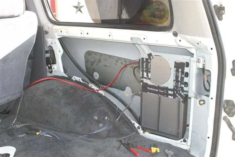

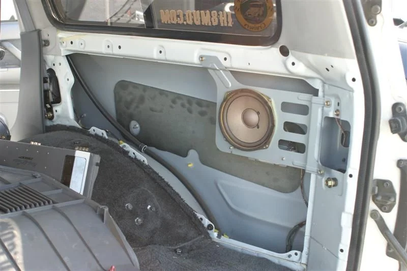

Here is a pic of the space. I was really hoping to mount the amp facing to the inside given the fan would almost line up with the factory speaker grill for vent. But that put the bracket on the backside, so kinda funky on how to brace it?
Although, like I said Im just being a motard and not seeing a easy solution here......

I used a bunch of pop rivited 1/2" aluminum angle in there to make a mount for 1 10" speaker; my amp fit under the seat so no problem there, but maybe you could go aircraft style and fasten similarly? don't forget the dynamat, that is a buzzy "enclosure" once you exceed the factory speaker output, if you are going that route.

are you needing to retain that speaker?
if so i think you/someone could fab a similar bracket to the one the speaker is installed on to mount the amp

i am talking about the factory one in the pic.
i am thinking you could either use the panel its mounted too or make one similar to mount the amp.

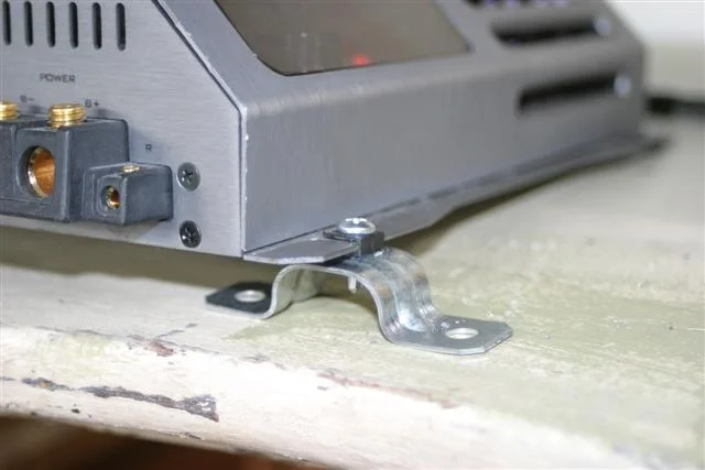

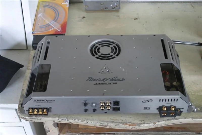

Not that interesting but here is what I ended up doing. There are 2 metal screw at the top, the tape is just extra, there is epoxy underneath is various other lower areas of the bracket. It the epoxy breaks or whatnot the tape will/should hold good enough until I can re-do + the screws at the top easily hold, may just rattle like crazy if it happens t break loose on the trail.
