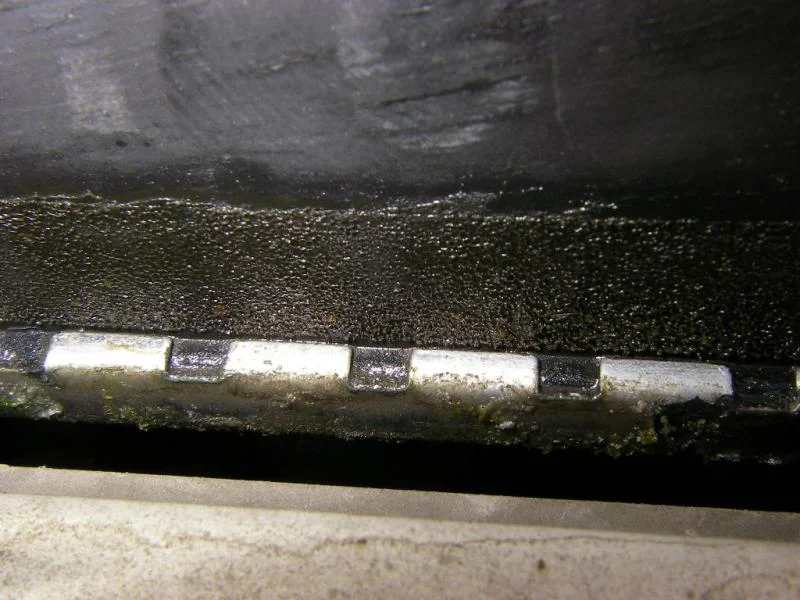

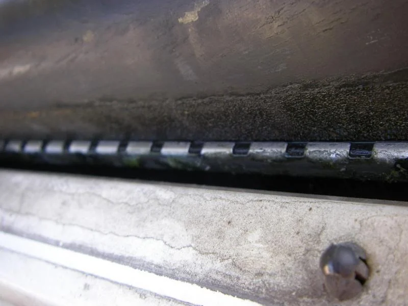

not the best time to take a pic: were it hot it would show a lot more wetness on the plastic bit

It could probably be fixed.... but there's a thin line there... Do you want to be tooling around in the woods with a band-aided radiator? Probably not...
Back to the real question.... No, I don't know first hand of any rad shops.... I think there's one in Yreka... But that's probably not the best option for you!

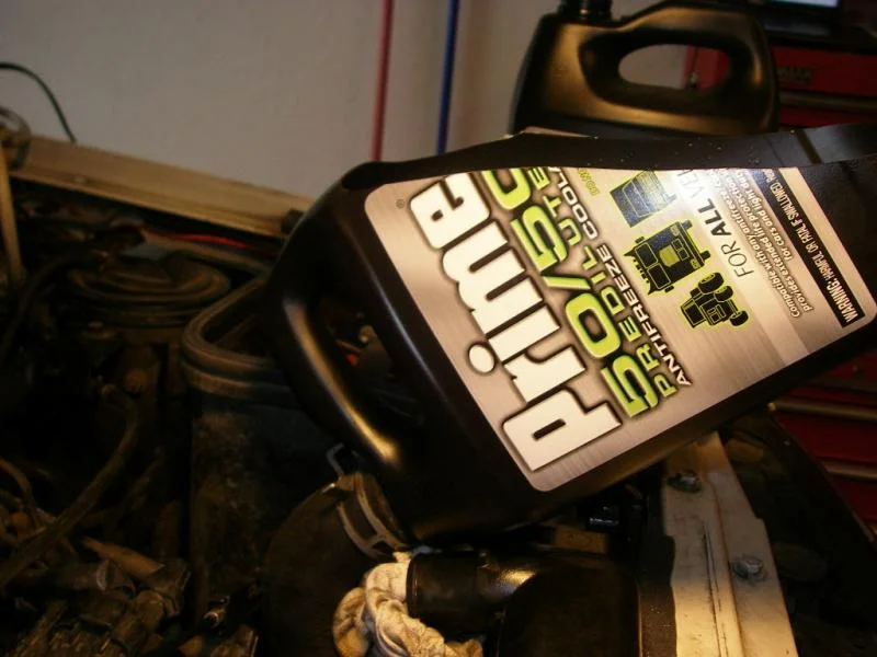

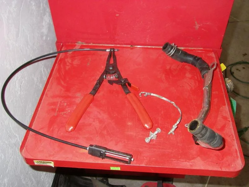

ordered parts from CDan, factor about 6 bills for rad and all hoses, Tstat and gasket. The crusher is immobile until I do this R&R; the whole top plactic bit is disintegrating at an alarming rate, where it used to seep only when hot, it seeps now when looked at closely while cold, and from multiple sources. Picture a bunch of paralell cracks running across the front of the top part. It looks like the crystaline structure is failing? is this possable? seeps now while cold and squeezing the thing with moderate pressure induces more fluid loss. I may have a cheap aftermarket unit but doubt it with the factory service records the PO had, more likely original and 216K have taken their toll.
Not loving the Mercedes, but enjoying the MPG

and also, if you don't have one of these:
Cal-Van Tools Flexible Hose Clamp Plier - 731 at Sears.com
or similar, you need one.

done and done
would have posted sooner but had to go tow the mercedes out of Philomath; master cyl went tango uniform sunday. wish I had the camera with me for that shot, two of the five most reliable rigs on earth, one down for a standing 8 count, being towed by the other bouncing back from an "injury hiatus"
but, I got the PHH-ectomy accomplished, all the hoses, Tstat and the radiator changed out, nothing special to report, the tools I have attached are big helps in the garage
#1 is self explanatory,
#2 - get a set of these for your modern hose clamps, you'll thank me. PHH clamp came off like a sardine tin lid, after the gearwrench and prybar attacked the TWO BOLTS? that hold the 7 inch? rigid pipe to the back of the head it was a piece of cake popping that sucker apart; longest part of the job, not counting the bike ride in the rain to NAPA for "green" stripe, (mine is yellow) and shielded clamps.
#3, you can get at least a gallon in the block this way, probably more if you are willing to let it burp and settle out longer than I gave it.
and a half, more frustrating than changing the belts, but not terrible.

what's the crazy cable thing? and where'd you get it?
2ndGenToyotaFan is offline   Reply With Quote
Old 03-25-09, 09:04 PM   #30 (permalink)
250+ Club
tblume's Avatar
Join Date: May 2008
Location: willamette/umpqua divide
TLCA# 19103
Posts: 848
sears, its a remote hose clamp taker offer jobby. works slicker than a big set of plyers everytime unless you can't get it in position.
