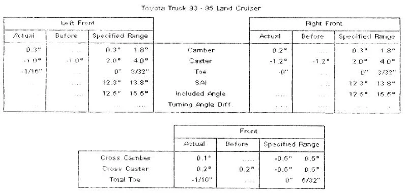

Ok, so rather than create a new thread....
Lift, SS, and 25mm front spacer are installed now
Need to get my Caster checked. Any recommended shops around here to get it done properly?
I was thinking Expert Tire or Advantage maybe? They both have done a bit a work and tires on our company rigs.

Here is the results: (i posted up in the big pool too, to see if anyone saw something to outta whack).

Here's were mine were/are:
CASTER with J SPRINGS
STOCK BUSHINGS: -1.7* & -2.0*
OME BUSHINGS: 0.4* & 0.0*
LANDTANK PLATES: 2.6* & 2.4* (we rotated the axle 7* to achieve these numbers)

Thanks G
Im leaning towards LandTanks plates. But he says I will need a new DC shaft.

Ok so on a strict budget to finish this, I went with the Slee Blues. Rick @ nelsons said he would try and press the old out and new in
So that pretty much uses up any cruiser cash to get me through the summer
