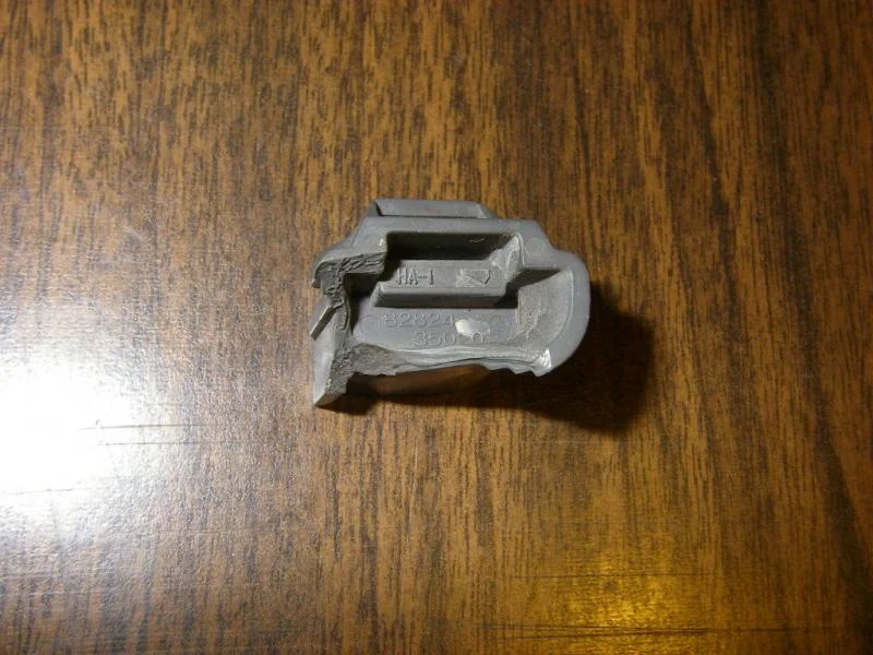

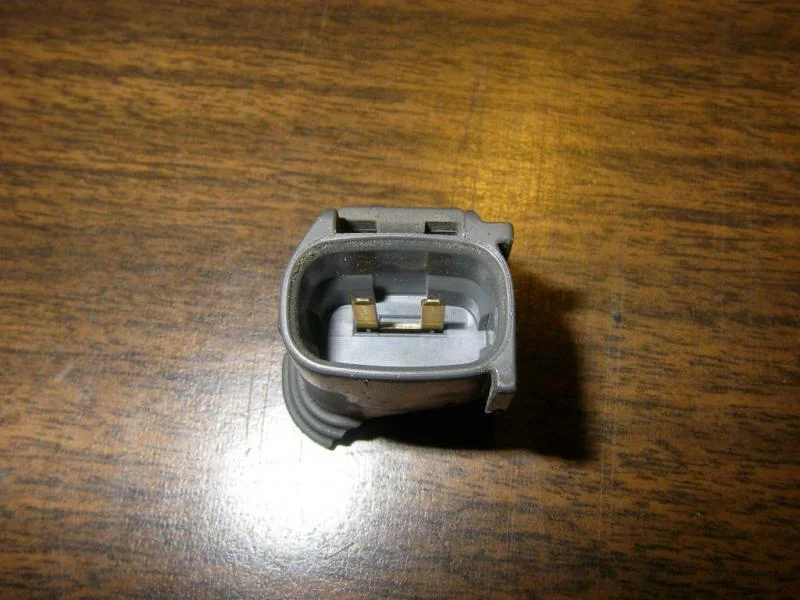

plug pics and P/N (?)
Gabe- PM sent without pics; do I need a silver star to add pics to PM?

Posts: 3,448
I don't know about adding pics to PM's, don't think you can.
That's definitely just something to keep the loop open. That must be the way of disabling EGR. My question is.....how did it get on your truck? The '93-'94's all came factory setup for Cali emissions (or so I've heard) and the bolt plugging your EGR temp sensor hole does not look stock.
I'm calling cdan and Lithia tomorrow to see if either can get me one.

Quote:
why- no P/N?

$17.43 from Lithia. It's a class E rating as far as availibility (A-F, F being the hardest to get).
There are two in a So Cal warehouse. The only two in the US. I ordered both.
