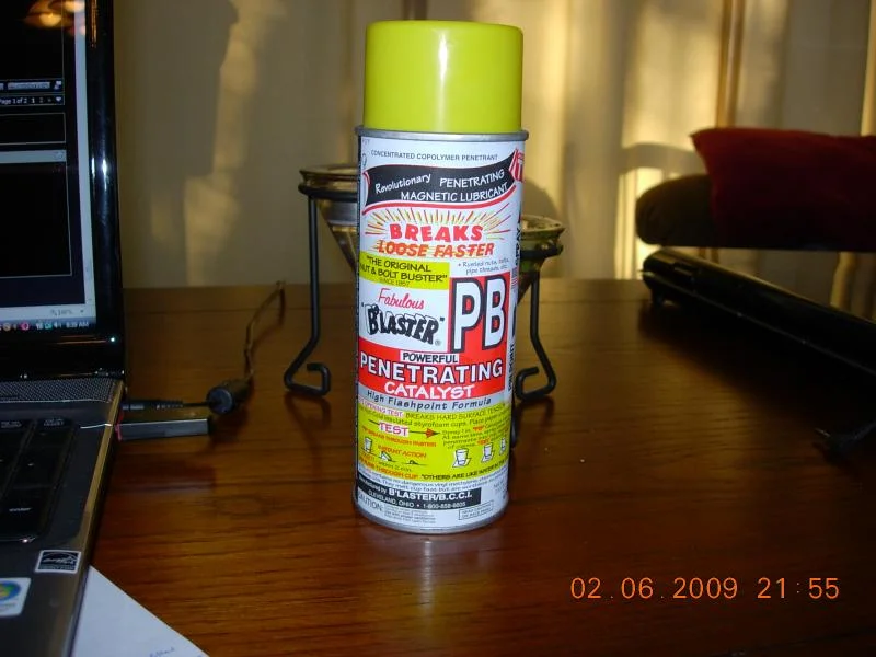

Quote:
Originally Posted by TOY350 View Post
PB Blaster
That's it; amazing stuff.

Thanks C - Ill pick some up.

One other Q on product, should I also get some anti-seize like recommended?

For around 15 buck you can get a jar of silver permatex anti-seize and you won't regret using it.. use enough-not too much. It has an applicator brush that is real handy. I have had the same jar for 15 years.. scraping the bottom finally.

So PB Blastering it all week and still can't break nut loose on the shock. From the looks they are (shocks) after-market . Not 17mm nuts like most the articles I have read. They are x2 19mm nuts on top of the shock wrenched down on top of each other.
Picked up a blow torch today , if that dosen't help then parrifan wax and torch..... if that doesnt work pretty much just going to sawz-all the thing off lol.
Any ideas on this but job? Lol. No serial, Ive seen and used 2 nuts to really get a good secure.... not going to vibrate out nut bolt thing before.... but when it comes to un-doing?
