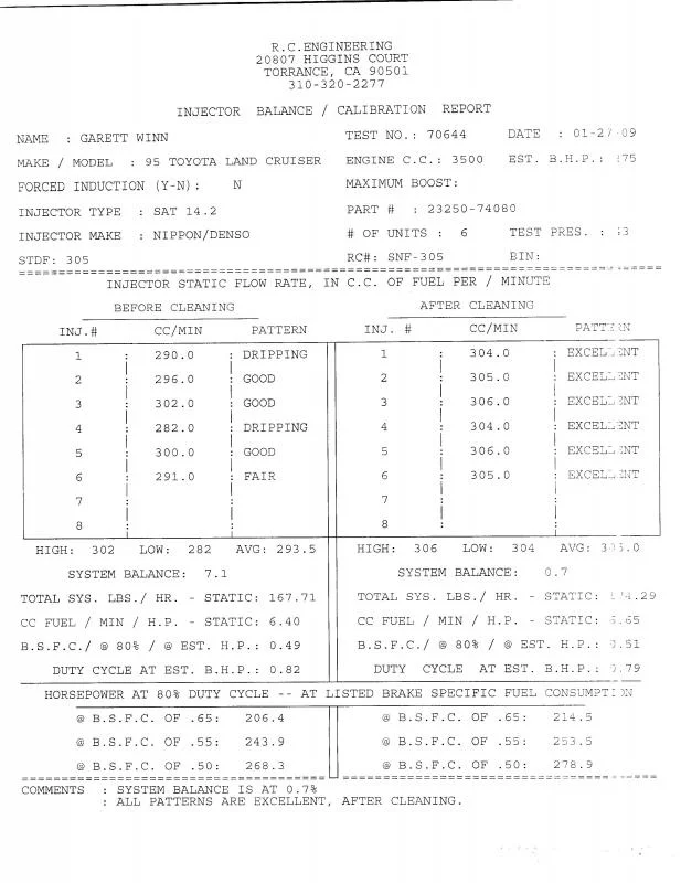

Putting it back together wasn't bad at all. Here are the numbers from the injector cleaning. I will post back after I run a couple of tanks and see if there is any mileage increase.

Interesting. So they say that you're getting 10 HP by cleaning them. (Not at the wheel, of course.)

Interesting stats. I would think the dripping would be real bad but the flow is really a pretty small percentage, will be interesting to see what the gains are mileage wise.
I would assume a lot of your driving involves short trips and the motor spends a fair amount of time running at less that fully warmed up which would mean less than optimum operating conditions. I think I'll go buy some injector cleaner just for fun..

I'm guessing maybe a little power might be picked up by the cleaning, probably won't be able to tell from the seat of your pants though. Might run a little smoother too. At least you know your injectors are all in good shape now.
How much did the cleaning cost for future reference. I know new injectors are $$ so it would be nice to just get them serviced as a good alternative.

The cleaning was $165 including the 2 day shipping back to me. If the shop in Medford can do them I bet it would be around $120 to $150 for the job and you can save on shipping. I didn't contact them so I don't know if they do a readout or not, which isn't really necessary but for those of you that know me...well then you know why I wanted the printout
So far it does seem to ride smoother and takes less pedal in some areas I drive regularly. True test will be the next two tanks of gas though, I'm not holding my breath though, I seem to be a magnet for bad mileage and overheating in every Cruiser I have owned so far
