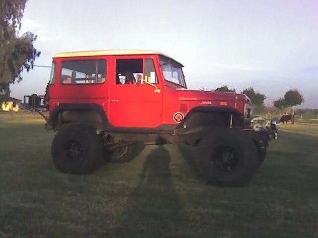

Well, this is where my rig stands now. 100" wheel base. My front axle is so far forward, that if I didn't have a winch, I might have close to a 90* approach angle. The back looks a little lower in rear, but that is because of where I was parked. It sits level thanks to Jerry's shackles. Only other body work will be metal tech like rear fender flares and of course, maybe painting the rig desert sand or dune beige.

Fj looks really good, You could fit 37" tires with no problem, Maybe 40's

40s mean axle upgrade and 37 won't let me fit in my garage. Only way with 37s is if I figure out a cheap harbor freight winch that could suck up both axles at the same time so I can squat into the garage. It would be to much of a pain to have to air up and down every time I wanted to go for a drive.

Man you must be pretty high. I fit mine easy in the garage with 37's and had about 3" to spare.

I am considering taking out another leaf in all of the springs. I have stock size shackles in front with stock 40 sprins with a leaf out. IN the rear, I was sagging an 1.5" so I threw on some longer shackles to level it out.
Your right, it does seem high, but that is with my hard top on. WIthout the hard top, I have plenty of room. DId you take that into consideration? See you tomorrow!
