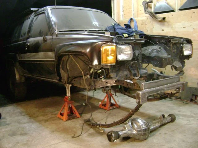

Well, after all this talk of "Island-a-thon", "Canol rd.", and summer just around the corner, its time i do something somewhat productive with my time at home aside from just drink beer. My wheelin' rig is on the backburner, so i gotta get out wheeling with something, hence the turbo 3B transplant with 60 series axles into my 88'4Runner. It'll be a "get-a-round" towner when i'm home and a partial wheeler/camping rig. It'll have to do for now til'i get a decent 80Series donor for my 4BTA transplant.

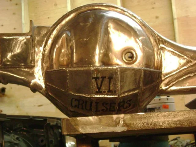

Here's a couple pics, from today. Tore out the 22RE and IFS, got some armour on the HJ60 housing("Flyinglow"-recognize the housing??), and a spring mount built.
More to come later.

what you're not doing it in the gravelly lumpy ass driveway? yer gettin soft...
never mind the 80...4BT in the CRV....
You should rattle can some mexican chrome on that diff, then you'd have the totally awesome disco ball look goin on under the front end...

A 3b 1st gen 4runner......so cool. Love those 4runners.
Solid front as well, nice. Plans for a turbo???

Merindian: i'm trying hard to keep with you on half-started projects...LOL i'm just missing an indoor hot-tub on the lawn and a copper farm!
Potato:i know where to find ya', i'll just drop a handfull of pennies in the crevices of that beer can, and watch it melt like a true cruiser...
Cam, yeah i'm planning a turbo, had too many slow wagons to forgo this one.
Got the front axle finally done tonight, made up some ball gussets, steering stops and shock mounts. This thing is slowly turning into one thing after another just like most projects! The gas tank is on the pass.side, where the driveshaft goes so its gotta go. Started the engine mounts and will burn em' in once the axle/springs are in tomorrow, along with a tranny mount.
Hopefully it'll be "Land Cruiser" enough to make it out to a trail run with you guys...!?!?

Great work with the VI Cruiser diff guard.
haha...yeah thought i'd put that there for kicks.

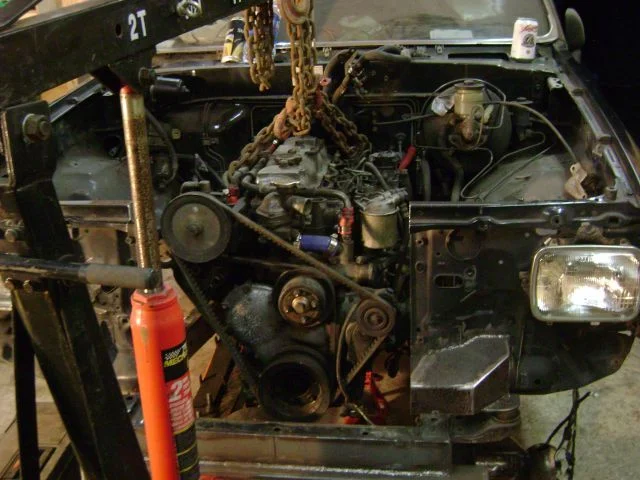

Bit of a slow week, but got the front end in, shackles mocked up and the 3B shoe-hormed in. Its a little tall, which i knew would happen, but fits well non-the-less. Got some steel cut up for engine mounts and gonna throw a mild body lift to make some room in the tranny tunnel. My good friend "Cousin Cleatus" was hard-at-er' helping to get this thing put together.

Here's a pic of the mill, gonna be a little tight with exhaust and turbo. The tranny hump is much smaller than the cruiser ones so a small body lift should give a little extra room for engine mounts and strarter which sits just about on the frame rail.
Another issue is the tranny mount sits just about directly where the shackles are and the transfer case is a knuckle dragger. After pulling it up as close as possible everything cleared so we'll burn in some engine mounts and see how it sits.

too cool man. should get great mileage too. What turbo?

HX-40 from a Cummins...
