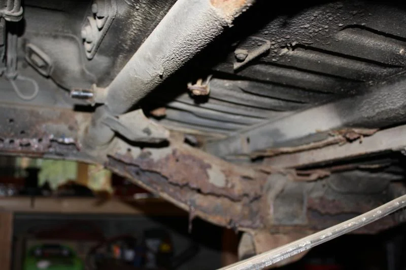

The first vehicle I ever drove was my old mans 73 FJ40. Drum brakes, dangle down wipers, and no power steering. Growing up on Saltspring Island it was the ultimate go anywhere mobile. Now many years later I have a 85 BJ60.
The 60 is in the garage at the moment with the back end stripped for some frame repair. Man, I must have removed 30lbs of rust from the frame yesterday, when the iron oxide cloud lifted there I was asking myself what I had gotten myself into?? LOL!
Soon it will be time to turn the corner and start the rebuilding process. One must first go backwards in order to go forwards right???

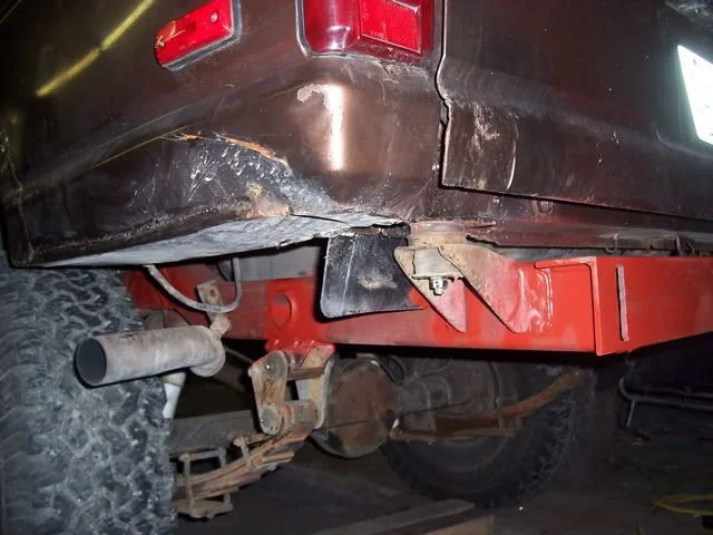

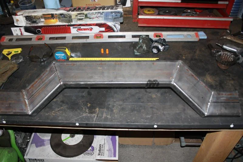

hey cam,
here is what i did for the rear of my bj60.. give me a shout when you got time
adam

Nice! Where did you get that bent channel? Ruff Stuff?? I like it. I started with the idea of just patching up the frame but now it has snowballed to something more permanent with upgrades all over. LOL. Oh well I'm cool with doing it once the right way.
I need more jack stands..... got any tall ones Adam??
Cam

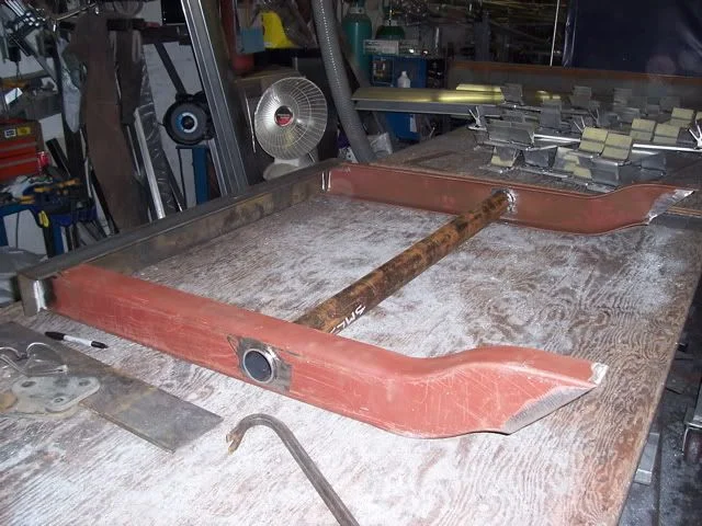

I'm thinking ill cut my frame infront of the front rear spring mounts and build from there. Or just keep on plating the existing frame...... kinda on the fence. Hmmmmm

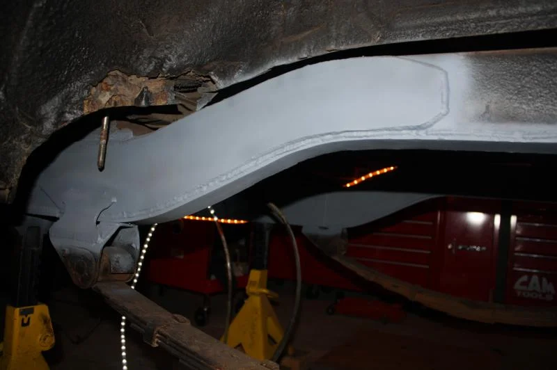

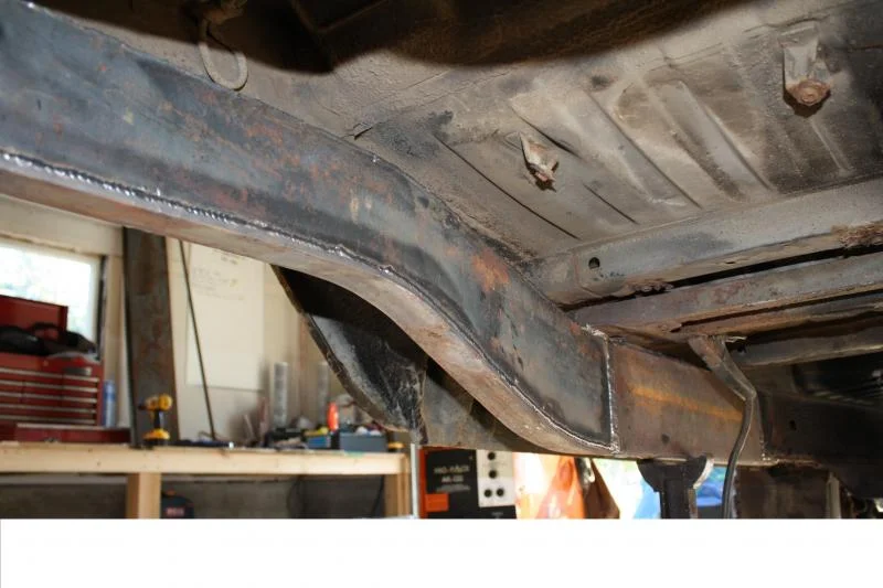

Well got one side mostly done and the other is .5 way. I need to rebuild some body mounts and install a 2" body lift as well. She's comming along slowly.
Picked up some heated seats today so I'm sure that will interfere with the frame work schedule. lol
Cam

did you use a grinder to cut out all your templates for the new steel??
could of used the plasma.. if you need too...

Thanks Adam. I made a posterboard template and then cut the steel with a torch. Its a slow process but I cut two of everything so the next side stuff is all cut. 2nd side will go much more quickly. Well i'm off to the garage to get filthy.
Cam

Did you do the outside of the frame too if so try an avoid vertical welds or use a diamond plate over the spot. Just info for ya. Did you build it in pieces ie top, bottom, sides.

Both the vertical inside welds are in factory locations where toyota did the same thing so i figured it was OK. Yes I also plated the outside and the bottom. I built it all piece by piece. I have more pics but seem to be having trouble posting more pics. seems my attachment folder is full. I tried using a url from photobucket but that didn't work either... WTF? ideas?

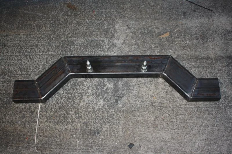

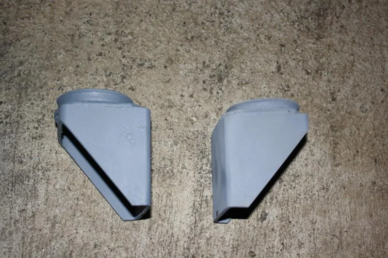

Here is the outside (avoided vertical welds) and the body mounts to replace the rusty ones fabed from 1/8 box tube.
Cam

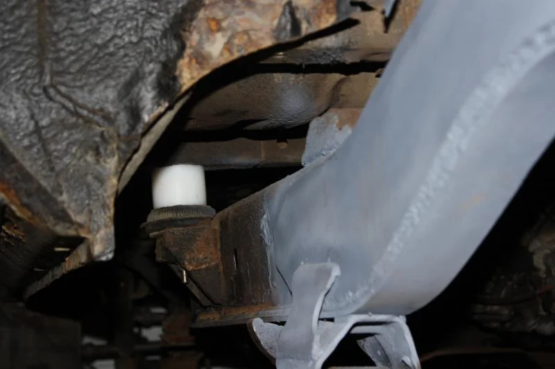

Installed a 2" body lift yesterday made from UHMD 2.5" and 2" cylinder stock. Now I have to lower the fan shroud and adress any shifter clearance issues assiotated with the lift. Having the body raised will help me mount the get the upper rear shock mounts as high as possible. Should make for better angles when building rock sliders as well. Next stage is axles.... then seats..... then a center consol of some sort.... will it ever end? lol,

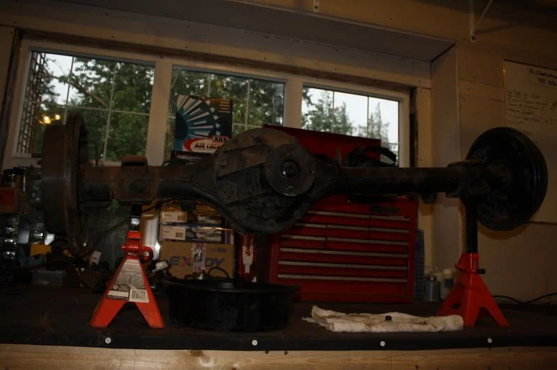

Pulled the rear axle apart yesterday, spider gears looked a bit worn but not too bad otherwise. Not that it matters as everything is getting replaced anyway. Ill get the new bits in and set up a.s.a.p. I'm off to go dumpster diving for steel in town, I'm goung to try to scavange some aluminum at a buddys shop as well.
