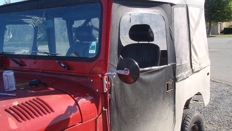

Here's a couple of pictures of that mirror I threw together... quick and easy way to add a mirror to a mirrorless cruiser... cheep too !
Part numbers and stuff in the link in my signature... more pictures too
