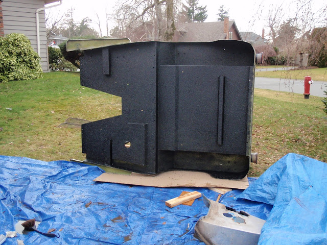

well the bottom of the tub is now bedlinered... looks pritty good I'll try and get some pictures up soon if I can.

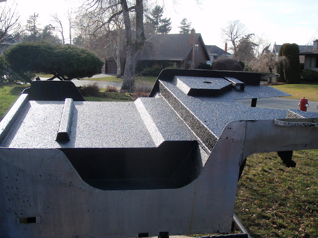

new Tub pictures
Heres a couple of shots of the tub:
And the bedliner job:
Partway Done:
Done:

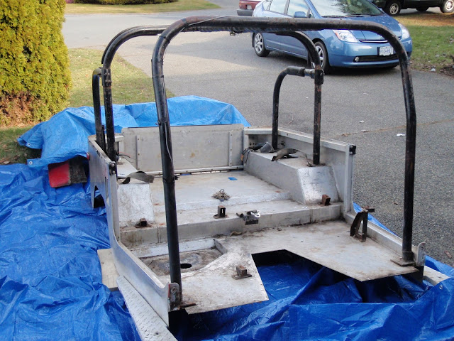

Pictures of the truck getting torn down for the new tub are here:

It was a proline product I beleive. I think I still have an empty can or half empty can in my trunk... I can double check tonight if you want. I used a funny little gun called a BUPA gun from lordco to spray it on... costs about 30 dollars a can for the bedliner and 20 bucks for the gun... I put it on relativly thick and it was about 2.75 cans to do the bottom. I'm really happy with how it turned out and will probubly do the inside once the weather improves...
basically you are supposed to have a 10-12 hr window without rain to do it in but in reality you need a bit more to wash, dry, prep, and prime the aluminum before spraying... should be a good day project...

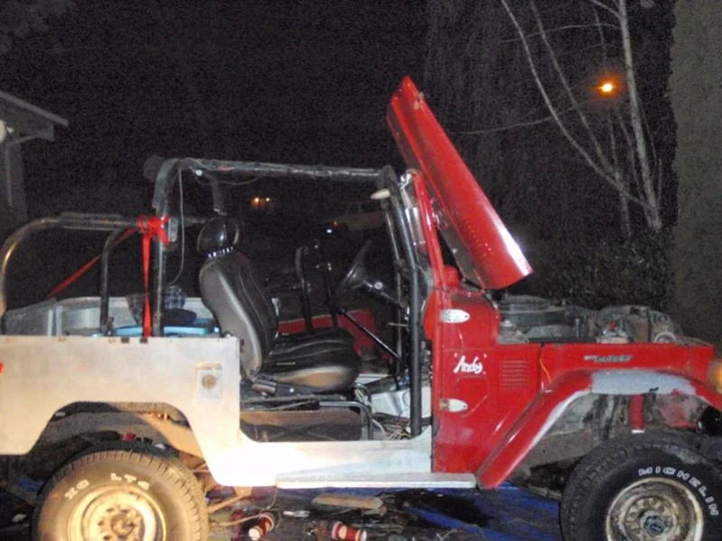

picture as it stands now bad weather lately but I need to add rear wiring still and also a muffler ....
