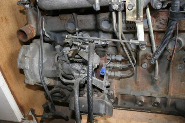

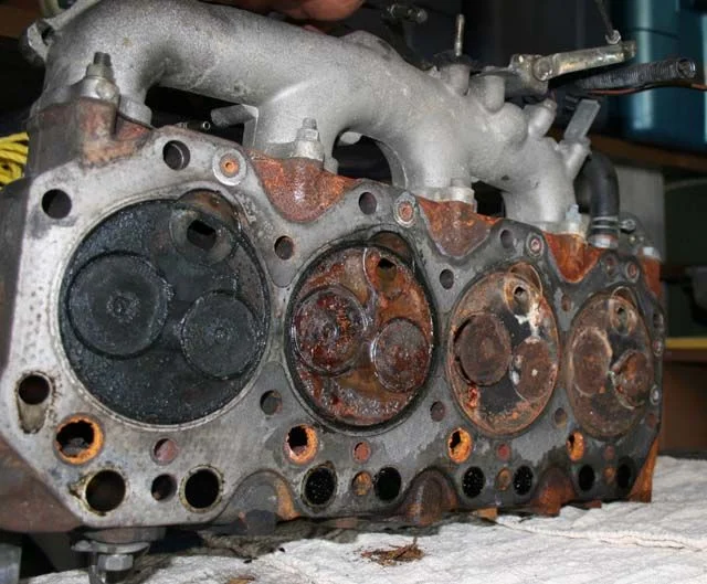

Awhile ago I purchased this most excellent 3B from my favourite friend named Greg and my favourite friend named Sheldon for a most excellent price. I bought it for the rotary pump, however, it never hurts a girl to have an extra motor kicking around, just in case. Anyway, this weekend, one of my favourite friends named Chris and I took apart the motor to see what was wrong with it. These pictures are primarily for Bruce and Greg as I know they're probably curious to see what exactly it looks like. Take a peek for yourselves if you like....

It has been sitting awhile....

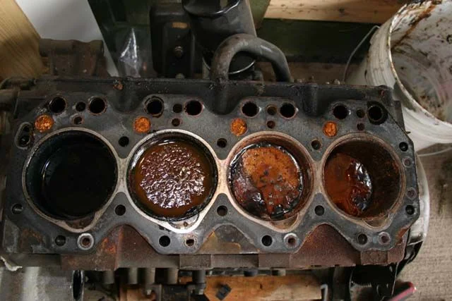

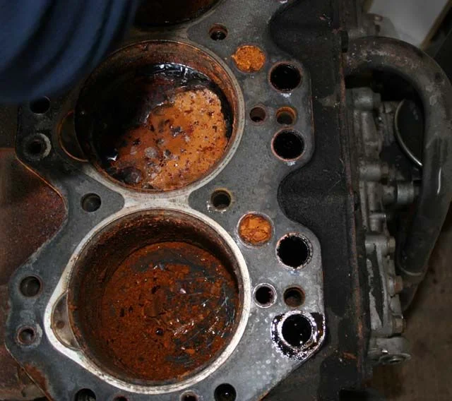

Hauled out the shop vac and sucked up the grime - cleaned it up a bit.

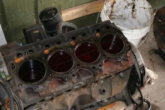

Ah. It's soaking with ATF at the moment. Will use some fluid film tomorrow and clean up the cylinder walls a bit more.

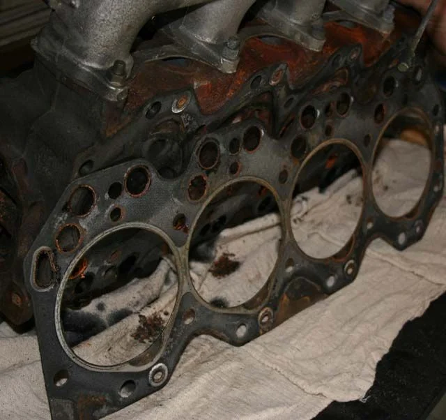

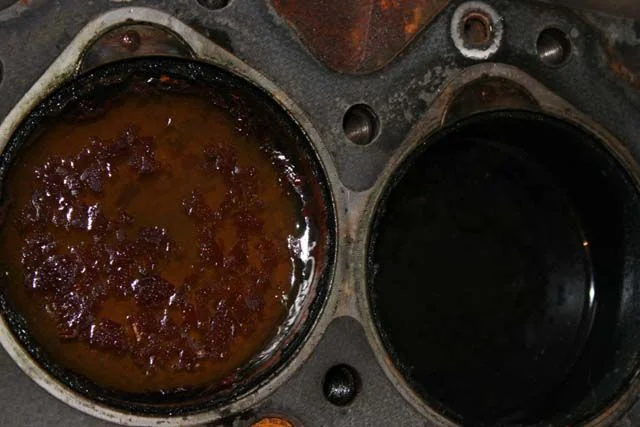

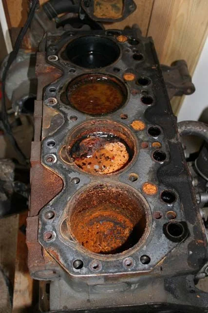

Looks like a good core. You're gonna be putting pistons, rings and sleeves in anyway. Have a look at the head for cracks between the valves and look in the bottom end to see what the crank looks like.

Also, check the precups for cracks. Is the IP chain or gear driven?

Toss the precups regardless of how they look. No chains on a 3B but it makes up for it with leather and whips.
