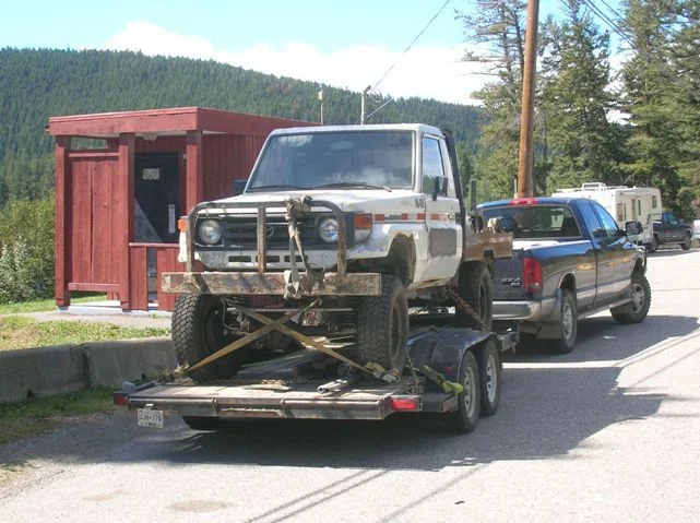

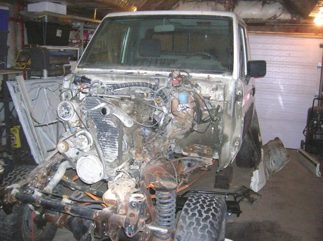

Well, here goes. A year has almost gone by, and I'm still no where near being ready to drive it, but hopefully thoughout the winter I'll be able to turn this old mine truck into it's former glory. Here are a few pics of how things started. First a picture of before I owned it, second after it's cross country trip to my parents place and a bit of a washing, and third after Cory from Kodiak did a little work on the suspension (I finally got to see it in person, and haul it up to Fort St. John).

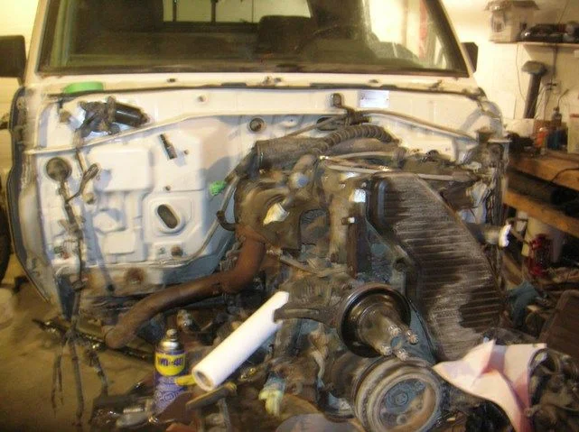

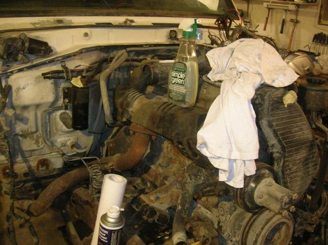

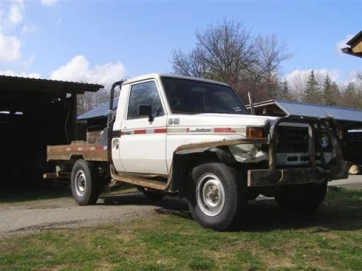

It sat for a while in the back alley as summer continued, did some wheeling, and other things before getting ready to start the cleaning process (plus Jim and Lindsey moved up here during that time too). Just after getting back from a hunting trip with my dad and brother, I started on ripping the deck off with the help of a buddy. Then the front bumper and the whole last weekend to clean out a fully stuffed frame. Took the bigger tires off (will probably go with 35x12.5) and put on rusty's 31s so it hopefully will fit in my shop. Frame will probably get a bit of a sand blast and a good painting.

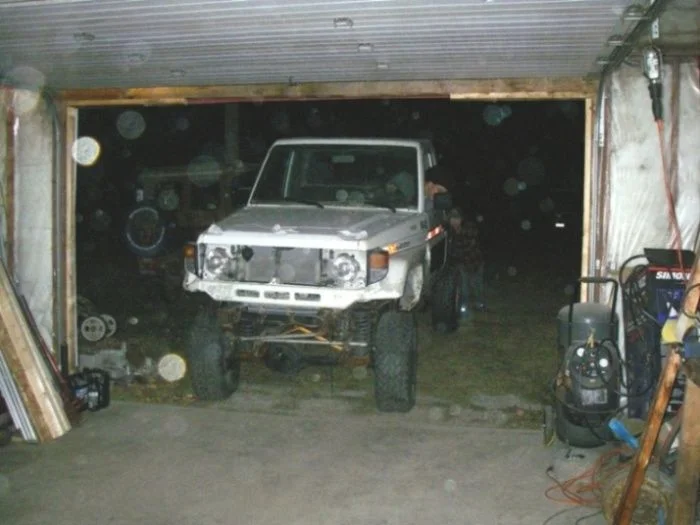

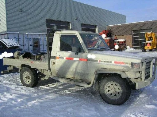

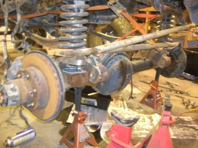

Here is a close up of the front suspension, still need to do the shock towers and some custom steering arms, as the OTT arms hit the coils on full turn at the moment. Finally here is where it sits now, clean frame, and truck ready for some stripping.

That is really a cool find! Did it come from Ontario? There was a guy in Tumbler a few years ago scootin around in a 93? What did that cost? Gotta be a Diesel too right?

Quote:
Yup, came from Ontario, cost 14,000 plus shipping. There is a guy in Dawson that has a BJ75 too, heard he bought it strait from the dealer in PG. Has to be diesel, or I wouldn't be drivin it. If you want more info on it, or how to get one, send me a PM and I'll forward you to the appropriate person.

Looks pretty good Deny! Well, it will look better once you clean it up

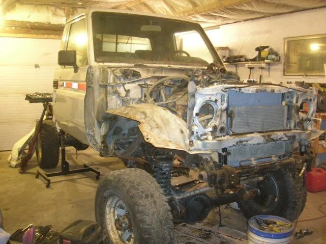

Did you end up buying a front clip from G and S? Once the body panels are replaced it will look awsome. Dedicate a full day to dissassemble the interior - go right to the firewall as there is alot of dust in there to clean out. I even dissassembled the air blower box and cleaned it out.
Dedicate another day to cleaning interior parts, I had a big plastic rubbernmaid container that I filled with hot water . I would just soak and scrub with a scrub brush and spay fantastic on the parts and pieces - everything come up to pretty much new condition - I even did the inside of the vent tubes.
The headliners are nasty - but buy that acrpet cleaner fluid you can get at home depot or sears - whatever - and soak and scrub - the headliner comes out like new as well.
Once my rocker panel was in I used POR15 on the whole inside of the cab, and - strip the carpet off the floormat as it is soaked with dust and shit and won't get rid of water when you wet it. I used FATMAT sound deadener material on th ewhole insde of the cab - from top to bottom - and I used an under hood deader on the insde of the roof as well to make the inside very quiet - I would think about doing that as well. I also popped the panels off the doors and did them with sound deadener. That takes a few hours.
Thats it for now!

No front clip, thinking of just gettin brand new fenders from EBI, the rest is salvagable, plus I want to do a little extra welding and rubber mud prevention on the inerwheel wells anyway.
Thanks for the cleaning tips, what kind of product is fat mat, spray on? and where can you buy it?
Did a little more work on the truck last night, and man, some bolts are like new, yet others are rusted and I've already snapped a few (brings back memories of fixing up my 1982 cruiser!). I'll make sure to clean everything, replace all that needs to be, and rust proof the hell out of it.

Fat mat is a tar like mat that is sticky on one side and has foil on the other - you peel and stick basically.
Bolt you will snap will be the inner fender and lower fender bolts - my advice - take your time, heat them and turn them out - but watch for fire Also, don't buy any toyota fender clips and quick nuts - I have a bunch her e- and they cost me about 5-7 bucks each! Fricking crazy.
I POR15'd the inside of the fenders and most of the rest of the front clip - should be good for a while.

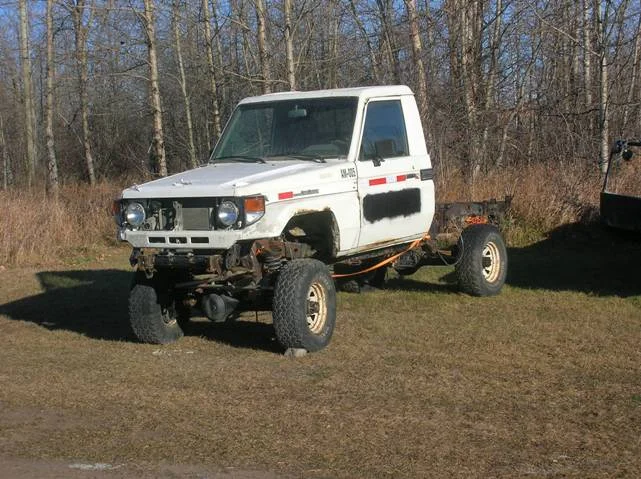

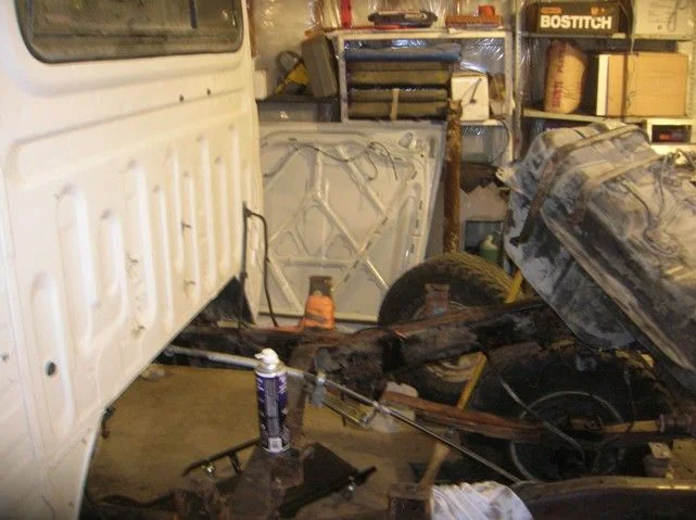

Well, finally got to do a little more last night, as I didn't have hockey. All I maneged to do was get the fender off finally! Those two bolts down under the clutch master were a bitch to get, espesially with all that dust crap that turned to mud cause I was spraying everything down with WD40 stuff. Got quite a bit of snow last night, so looks like winter is apon us now, definately glad I have the wood stove pumping when I am working in there, and it even stays somewhat warm to the next day. Heres a quick pick of what it looks like now. (3 bolts snapped, and 3 the heads were so rusty I had to weld nuts to them and take them out, but will replace all bolts, so not a big deal. Lower fenders definately need replacing, but the rest looks really good except the rockers I guess)
Cheers,
Deny

Where the wheel well inner fender was rusted (around the bolt holes) I just welded in some metal strip drilled new holes. I think the inner fenders cost over 300 each and decided to save some cash. I then sandblasted the remaining rust and used POR15 - 3 coats on the hole thing - should last a few years now.
The firewall had some kind of black rust proofing on it - the only thing that takes it off is strong varsol type paint thinner. Make sure your garage is well ventilated when you do that - and wear a canister mask. It also cleans all the shit off the hoses and rubber parts very well.

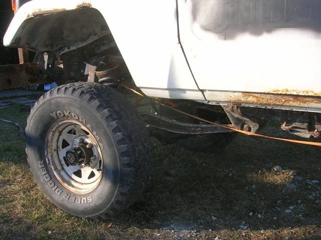

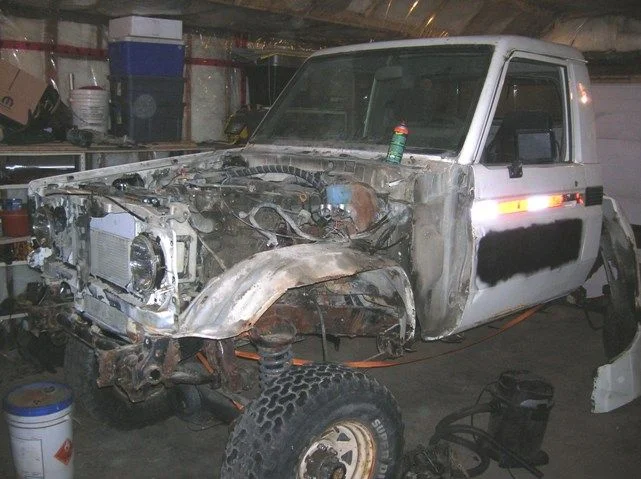

Well so much for the long weekend, did more drinking and sleeping than working, but got a little more done, here is the current state.

Are you going to take the cab right off? For the next one I rebuild the cab is coming off and getting line x'd. Also, remove yuor fuel tank while you have the truck apart - I had mine pressure checked and then POR15'd it. Also gave me a chance to weld a complete new heavy duty skid plate for the fuel tank.

Yeah, didn't really plan on taking the tub off, but I might do it like I did to my 42, just lift it up a bit to clean and treat the body mounts. Was planning on taking the fuel tank out though, as I plan to have it off when the frame is getting sandblasted. Hey does airconditioning gas smell like rotten eggs, as I cracked the lines last night, didn't smell anything, then this morning, Lindsay said it smelled bad by the shop.

Old 11-28-07, 09:50 AM   #26 (permalink)
Site Addict
Deny's Avatar
Join Date: Jan 2005
Location: Fort St John, BC
TLCA# 11568
Posts: 1,648
Well, thought I would post a pic of the current state, doesn't look much different, stripped a few more things, and started doing some cleaning. Sort of a bitch to clean up, as some of that dust is pretty much concrete, but once off, looks pretty good, almost new! Also posting a pic of my suspension, as I have a bit of a question for anyone in the know (I ain't no steering speciallist). Anyway, the drag link is at quit an angle, and I was just wondering if that is a big issue, or will I have to get some kind of custom dropped pitman arm (don't really know the terminology, but the arm off the steering box)?
Thanks.

Old 11-28-07, 09:22 PM   #27 (permalink)
disengaged...
Ratpuke's Avatar
Join Date: Jul 2002
Location: 633430 6236257
TLCA# 12070
Posts: 1,113
How's the Simple Green working out?

Old 11-28-07, 10:08 PM   #28 (permalink)
Site Addict
Deny's Avatar
Join Date: Jan 2005
TLCA# 11568
Posts: 1,648
simple green is pretty good, works better when it soaks in a bit, but some stuff is just really stuborn.

Old 12-03-07, 08:48 AM   #29 (permalink)
Site Addict
Deny's Avatar
Join Date: Jan 2005
TLCA# 11568
Posts: 1,648

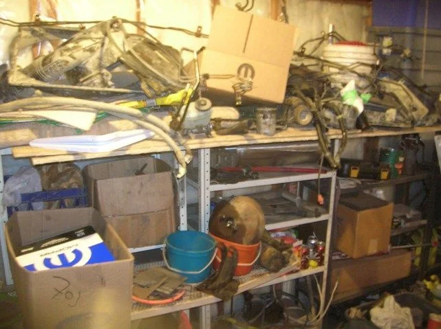

Done quite a bit on the weekend with the help of Nathan, and my brother. Worked hard all weekend to get the majority of it stripped down, most of the stuff off the frame, off the firewall, cleaned up some more stuff, stripped more off the engine, and dropped the tank.
Here are a few crappy pics of the progress, note I am running out of space to store stuff in my tiny shop. Note to Santa: need a bigger shop!
Cheers,
Deny

Old 12-03-07, 09:03 AM   #30 (permalink)
Forum Lifer
lowenbrau's Avatar
Join Date: Jan 2003
Location: Calgary AB
TLCA# 5513
Posts: 2,757
Quote:
Thanks.
It you need a drop arm, a 60 series one will get you another inch and a bit. Its a bolt on affair. Save your arm for a 60 series guy who's doing a springover and needs a flatter one to clear the leaf pack.
