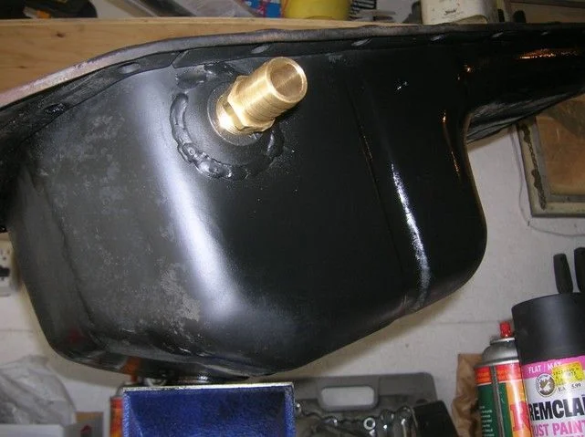

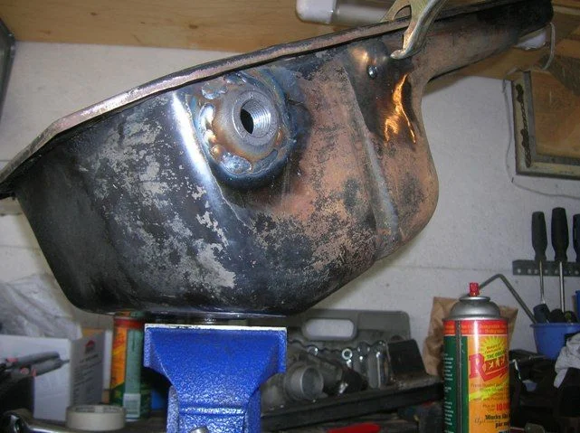

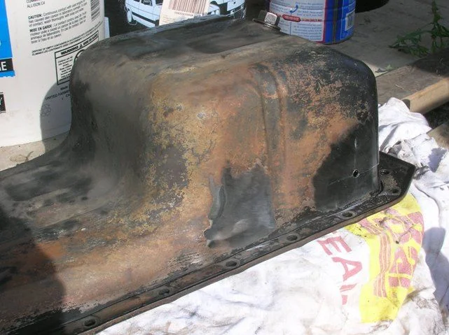

Well, I guess the oil problem was my fault. I bent the oil drain tube to pull it away from my jim shim manifold and that warped the contact surface leaving a little gap to spew oil out of. I smacked it back sorta strait, filed it flat, and added high heat silicone gasket to the already present gasket. Hopefully this will be it. Will fire it up again tommorow. Sent my money today, so should be getting the pictures up probably next week.

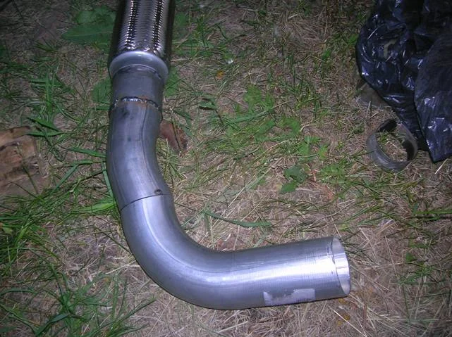

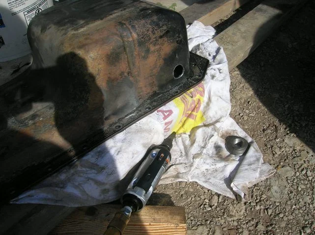

Here are the first few pics of my turbo build, will get on more as I get more time. The first pic is what I started with (thanks Wes if your reading this, for the turbo, works good) Then my weld on bung for the drain, and the start of the turbo flange cause I didn't want to just flip the manifold. The whole setup looks a little hokey, but it seems to work good, but what do I know never had a turbo cruiser before.
Cheers,
Deny

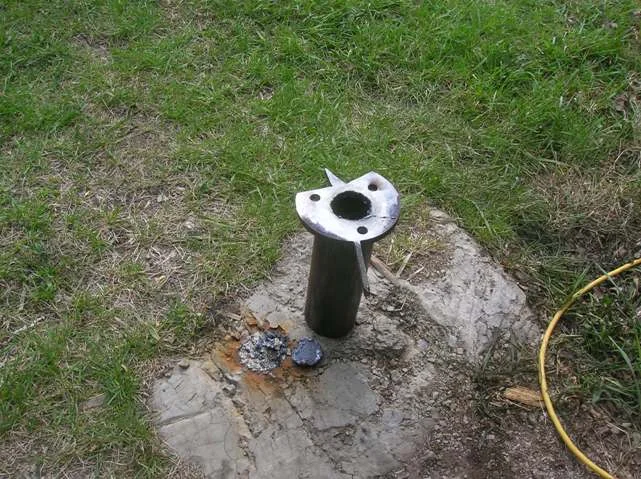

more of begining

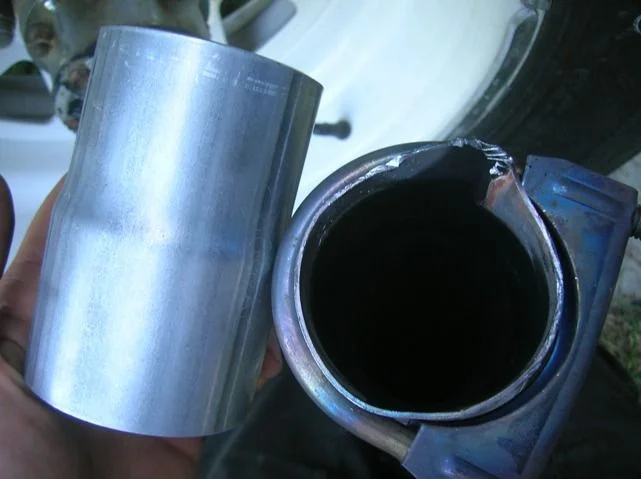

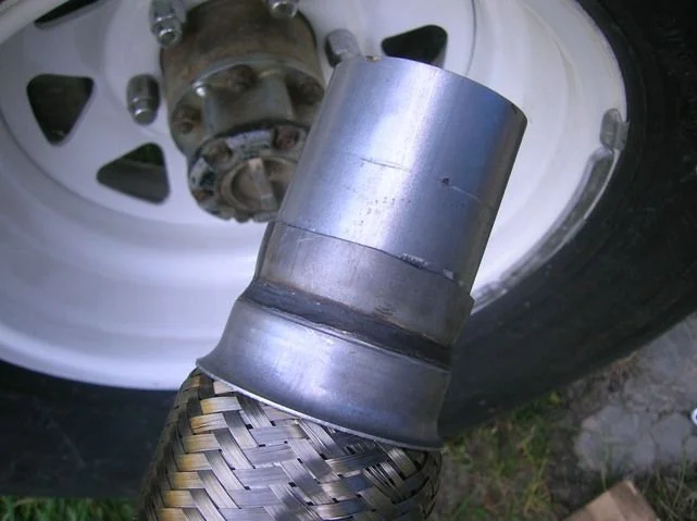

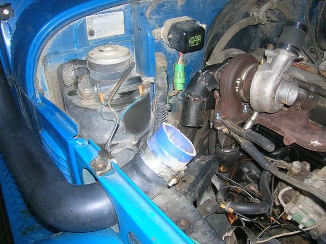

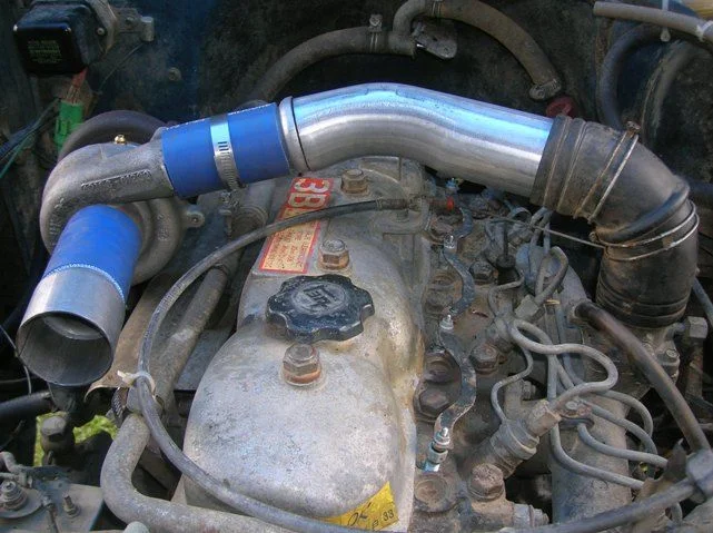

Here I continue building my jim shim turbo manifold/manifold extension. This way I could keep my air box where it was since I put a bit of work into it to rotate it around to fit my snorkle back in the day.

Interesting. Did you end up adding any kind of brace onto the manifold extension? If not, might be prudent to help prevent cracking with the weight and vibrations on there. Truck looks great with the 36's btw.

Yup I did but a brace in, I think it is in one of my later photos, will post up as I have time.
Thanks Martin, the Aired down 36s are kick ass for sure, and now with the turbo, it still seems to pull better with the 36s than non-turbo and the 34 ltbs (which were really like 32) The 2.5 backspace rims make it almost as stable too.

Here you go Martin, I didn't have a pic of the brace, but yesturday when I finally got around to changing the stock elbow into the intake that I had to jim shim since it had split I took a picture of it. Bacically it bolts onto the block down low and then I welded a tab onto the U-manifold part to bolt up to the brace also. (would have just welded it, but this way it was easier to put on and take off)

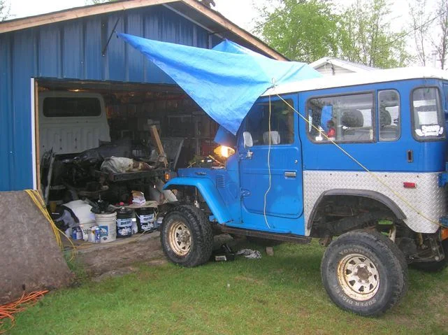

Started raining on me, and my project in the shop is sorta unmovable, so I had to make a temporary shop, worked pretty good, and I finally got to use some of those caribeeners I got at rivershiver. 2nd pic you can see how my snorkle attaches, and my little addapter to swing my air box to accept the snorkle. 3rd pic starting to make some progress.

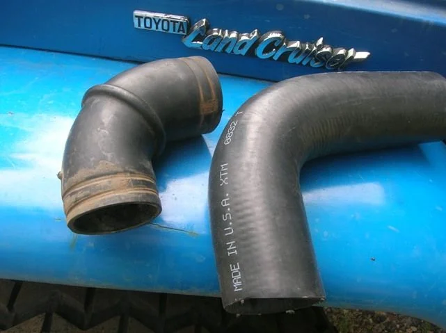

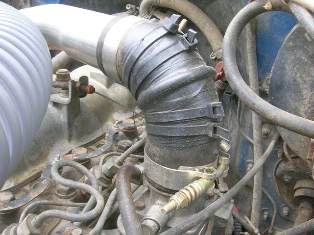

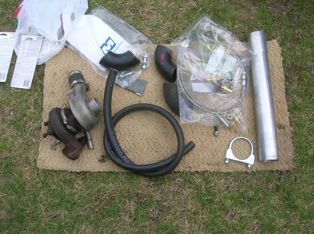

got some vaccuum hose for the air box to turbo line and pics of the little heat shield I made from some scrap I had lying around to protect the voltage regulator and some of the electrical wires.

Deny, that accordian hose will not be good with the turbo, I have a new HDJ81 airbox lid that comes straight out and the points down - you could use it and baybe cut it to the angle you wanted and then use just a short length of silicon tubing.
Let me know if you want a pic.

Location: Fort St John, BC
TLCA# 11568
Posts: 1,648
Quote:
Louis
Is it the same as the one you sent with the turbo kit? I was thinking of customizing something like that, this is sort of just temporary until I find something better, but it should hold up since it is industrial vaccuum hosing, I sort of like it too, because it doesn't rattle the hell out of my snorkle when the engine is cold. When I do get around to it (heck it took me 2 years to install this turbo) I'll make something better.

Yes - same one - forgot
Let me know if you need one - I have one left that I want to get rid of.

Yeah probably don't need one, this is a junkyard turbo set up, if I do change it, I want to keep the junkyard look and jim shim some more. So far I put in 200 for the turbo, around 100 for all the hoses and piping, and now waiting on like 300 worth of gauges. Oh and stupidly 400 for the damn exhaust that I had to pull apart and fix like in my next photos.

Old 07-07-08, 06:19 PM   #83 (permalink)
Site Addict
Deny's Avatar
Join Date: Jan 2005
TLCA# 11568
Posts: 1,648
Got my brand new bling bling 36s then I got to use the truck for work and that is when I split the stock intake elbow for the second time.
__________________
Diesels Rule
81 BJ42 and a few other cruisers
Check out my endless fix up progress at http://forum.ih8mud.com/showthread.php?t=152995
Deny is offline   Reply With Quote
Old 07-07-08, 06:22 PM   #84 (permalink)
Site Addict
Deny's Avatar
Join Date: Jan 2005
TLCA# 11568
Posts: 1,648
My split jim shimin and the fix and the how the exhaust guy just clamped and tightened the exhaust on which left a huge gap I had to fix by taking it off cutting the end off and welding in a neat 2.5 in pipe to fit snug.
__________________
Diesels Rule

Going insane at work, so thought I would take a break and post a few more pics that I have on my computer. Here is more of the exhaust fix and another pic of my truck I just posted in the diesel page:
__________________
Diesels Rule
Old 07-22-08, 05:54 AM   #86 (permalink)
250+ Club
tmarx's Avatar
Join Date: Aug 2005
Location: CAPE TOWN
Posts: 700
Thanx man! That "manifold extension" of your's has just helped me a heap with my RHD
__________________
Theo
105 1HZT I/C
BJ 42 LX 11/83 - 3b H55F P/S 3 wipers and slidin windas
tmarx is offline   Reply With Quote
Old 07-22-08, 09:27 AM   #87 (permalink)
Site Addict
Deny's Avatar
Join Date: Jan 2005
TLCA# 11568
Posts: 1,648
Quote:
No Problem, but I've only been running it for 4 or so months, so far no problems, but do at your own risk. I guess thats same as anytime you try and put a turbo on a non turbo engine I got the idea (and I think he's been running it for a few years, never seen it in person though, seen it before it was turboed) from Rob Penner of Calgary running it on his BJ60, so I can't take all the credit.
__________________
Diesels Rule

Old 07-22-08, 02:29 PM   #89 (permalink)
250+ Club
tmarx's Avatar
Join Date: Aug 2005
Location: CAPE TOWN
Posts: 700
Well then thanx to you and Roy both. It sure is easier than any of the alternatives
__________________
Theo
105 1HZT I/C
Old 07-22-08, 03:01 PM   #90 (permalink)
250+ Club
Join Date: Feb 2005
Location: Vancouver Island...Stuck in Fort Mac.
Posts: 256
Nice work on the turbo! What size weld elbows did you use?? Sched 40??
Cheers!
Rigpig is offline   Reply With Quote
