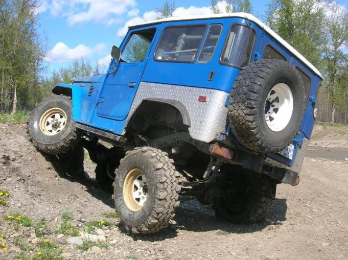

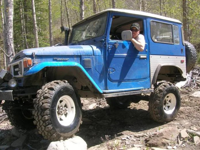

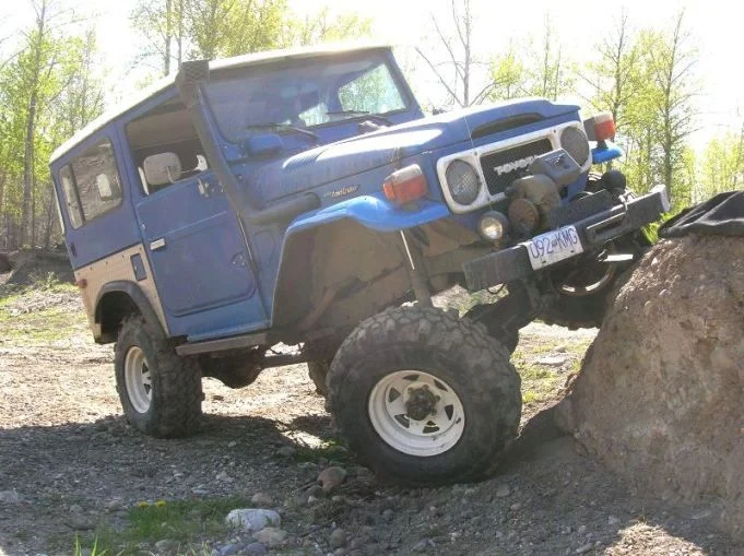

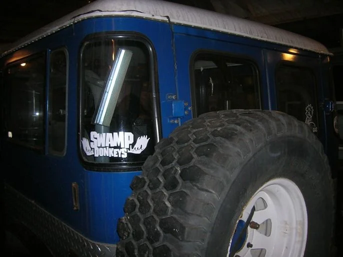

Finally the flexy shots:
Looks like I could fit 36 swampers, and they wouldn't rub, but to answer your question norm (from the other thread, because you are afraid to ask here, but I know you visit this thread, so atleast I know I'm not just pissing into the air, thanks.) I plan on running these tires for this year, cause that's all I can afford right now, but plan for next year to get 33x12.50 TSLs, just to be a bit wider, will probably be just a 1/2 in taller too. I don't want to make this truck too big, I got big plans for rusty.

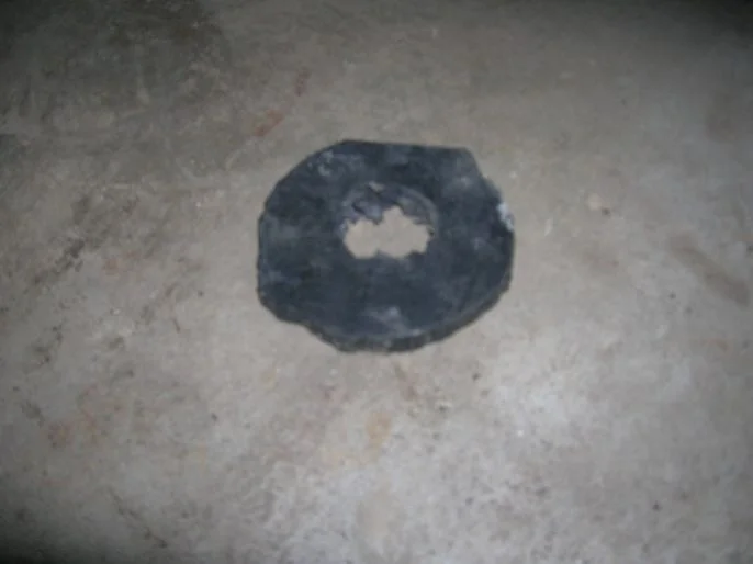

Oh yeah,
forgot to add, broke my rear shock mounts, and antiwrap bar clangs a lot when flexing, so will add some kind of rubber washers to quiet it down. Then a bunch of other little things like fuel filter, air cleaner.......never ends I guess.

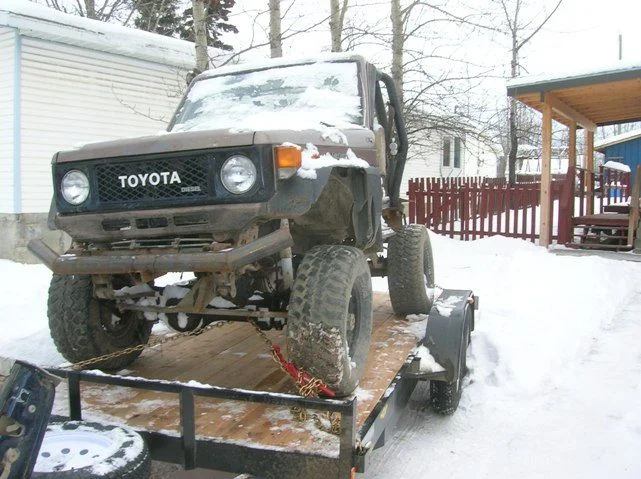

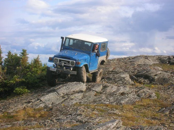

Here is a pic of not so much flex, but one I havent posted, so I thought I could post in your "matrix"

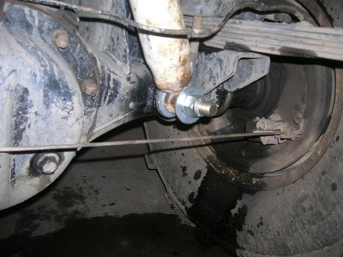

To get this thread back in the right direction, here are a few pics of how I finished up this weekend.
Welded on some heavy duty rear shock mounts, might have to get smaller washers, cause the 3/4 in washer is just huge. Got some rubber mud flaps from Kim to make washers for my antiwrap bar, now it's quiet. and put another sticker on.

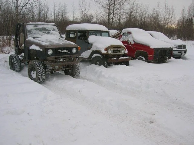

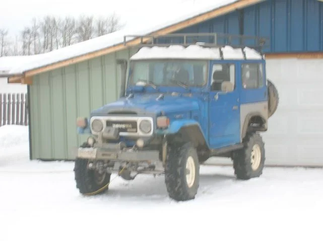

Well I thought I would update this one, since I am doing some work on it this winter, prepping it for some winter wheeling. Last weekend did the glow plugs and pulled off the front head lights as you can see from my pics for good reason (notice the lamps are dirty from the inside, and cracked, and somewhat broken) Anyway, while I am there, decided to respray the bezel, cause there was a lot of rock chips on it. Still a little to do, Lindsay mentioned I should make a list so I don't forget, so here is my list, so I can see it anytime I am on here:
-clean air filter
-clean battery terminals
-adjust rear brakes (for ebrake purposes)
-get new tires and rims
-fit chains
-(I might think of more, but this is minimum, anything else is bonus!)

Track bar is holding up well. The only problem might be that the bolt up on the crossmember gets loose the odd time, but I think I could fix that with a longer bolt and either double nuting it or lock nutting it. I think it might bang around a little under quick flexing, like going through crossditches, but also might just be my springs (leafs hitting the wrappers that I opened up)
I guess I never included the part where I had the driveshafts lengthened and first trip out on August long I snapped them (due to machining). 2nd time through they did up super beefy driveshafts and I have been hammering on it ever since, track bar has not snapped and it seems like I get no axle wrap. I'll probably build the same bar for my mine truck, but most likely with 3/4in tractor parts instead of the 1in.
The location seems to be ok, I just didn't have room due to my fuel tank, and figured one off center is still better than nothing.
As for flex, I don't know if it hampers it, since I never tried flexing without it, but it seems to flex pretty nice.
Cheers,
Deny
edit, heres a flexy pic from september long, cause everybody likes pics:

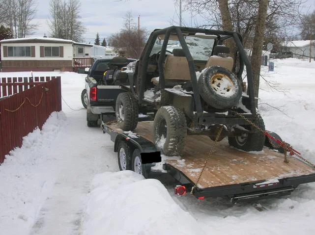

Well, this weekend sort of went awry and I didn't get much done on my mine truck or the 42. But I did get the 42 together and insured enough to go wheeling on saturday. Started off by going to pick up a parts truck. Thanks Nathan. Then we decided to go wheelin in the afternoon. was pretty simple wheeling, cause there wasn't too much snow, but still the snow up here has such a sugary texture, some times it can be tough to get through snow filled frozen mud ruts. Only took one pic of wheeling and that was of Nathans truck, but heres a pic of my truck as it stands, almost ready for River Shiver (note, have to take the roof rack off still which I put on for hunting)
Cheers,
Deny

Wha wh what?!? A buggied out 70 series parts rig? I need to see more pictures of that.

Ok, here are a few more. note Nathan built this as a last resort (so this ain't no show truck/ expensive tube buggy), since the body and rear frame were pretty much gone. He pulled the engine/tranny/transfer out to keep for parts for himself, so there isn't much left, but a few good pieces that will come in handy for my mine truck, my dads truck, and my brothers 60 (4.11s).
Cheers,
Deny
