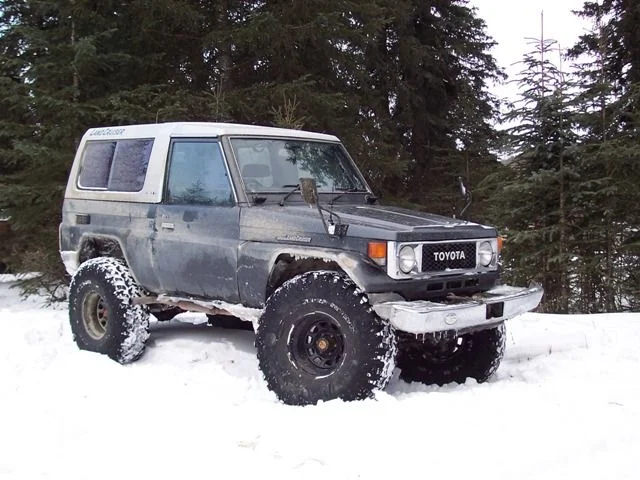

That sounds sweet and there's a few variations of the theme out there. Going 81 axles and coils would be interesting for sure. Peter's version soa on iroks:

How much scrub? Doesn't look like much clearance on the front guards.
