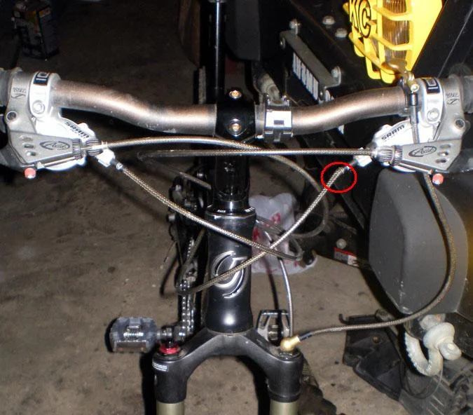

Old 08-27-09, 09:12 PM   #7 (permalink)
Forum Regular
lurch's Avatar
Join Date: Jan 2007
Location: Fairmont, WV
Posts: 199
__________________
lindsleyart.com
97 4Runner "Mean Green"
75 FJ40 "Smurfet"
96 4Runner - locker donator
07 Red FJ Cruiser (RC Version)
lurch is offline   Reply With Quote
Old 08-27-09, 09:25 PM   #8 (permalink)
Forum Lifer
2mbb's Avatar

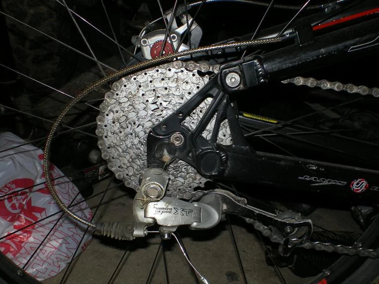

The front cable housing looks a little tweaked where it butts up to the shifter. Is it bent or is it just the angle of the picture?
If you're riding in the gearing shown, you really shouldn't be. You put a lot of side stress on the chain and you are essentially stretching the rear derailleur
Otherwise your cable routing looks OK. So I would start to look at shifters or derailleurs.
__________________
mbb
1985 FJ-60
2mbb is offline   Reply With Quote

Looking at that last pic there.. I would say the chain is waaaaaay to short...
Other things that you might want to cosider is getting a new rear derailleur and also look at the rear derailleur hanger, it may be bent.. try to reposition your front derailleur it would rub some when you have it ont he stand but once under load it should not make any noise....
I have used the Park Tool Website for reference...
Check it out..
Park Tool Website

Also.. I cant tell if you have a short cage or long cage.. derailleur..but you might want to use the long cage if you are not running it already..

But i did make some progress and fixed the front derailleur problem.... the cable housing separated. AND when I saw the problem it jingled a few bells...this is why I replaced the cable house the other two times. (It's been a couple of years since I MTBed)
SOOOOOOOOO..I got out the angle grinder and cut off steel "rods" of the housing, put it all back together with a new cable, and now it shifts correctly.
I imagine the rear derailleur system has similar problems....
Is there anyway around this problem? It seems that all housing tend to separate (at least ones that I've used)? Even with the housing end caps in place they still come apart!!!

So you replaced the cable but not the housing? I'm not sure what the picture above shows. Is that just housing with the stiffening wires but no cable? If that's the case, then that's a problem. You should be using a good set of cable housing cutters to cut the housing. Then you also need to use the ferrules. If the plastic ferrules don't hold up, then you should use metal ferrules. I experience the stiffening wires creeping out the ends of the housing, but never more than 1/4" or so.

That's a good question...I think they are compatibly because I can adjust the setup to work on the stand but after a few rides it acts up. I'm still thinking it's in the cables (based on the findings of the front cables) and partially in the XT derailleur. I did get it used and it has some good battle scares...probably a good idea to replace it with a Sram.
The gears selected are not the gears I run on the trail...just testing purposes. I set the chain up as long as possible, any longer and the chain sags in the lowest gears.
Quote:
Yeah those are just the stiffen wires sticking out of the housings...and I'm using metal ferrules. Not sure why it's happening so bad...but I did cut the stiffen wires down to flush. Maybe they won't move any more?

The problem is that some of the wires are now too short. Those wires are supposed to run the entire length of the housing. The wires are what keeps the housing from compressing. If the housing does compress, then the cable won't pull a far and your shifting won't be accurate. I'm back to recommending you get a quality cable housing cutter, and replace the housings with new.
