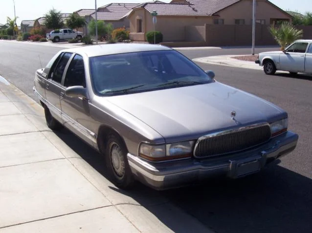

well, for what its worth, I picked up my donor (the 1995 roadmaster)for my '56 buick project;a strong running TBI (lt1 engine) with an auto transmission for $880 off of craigslist. It does have 110K miles, but it gives you some idea. If you want it as a van, its one thing, but if you only want it asa drivetrain, there are lots of comparable drivetrains out there andt he prices are cheap, so your bid should be too.

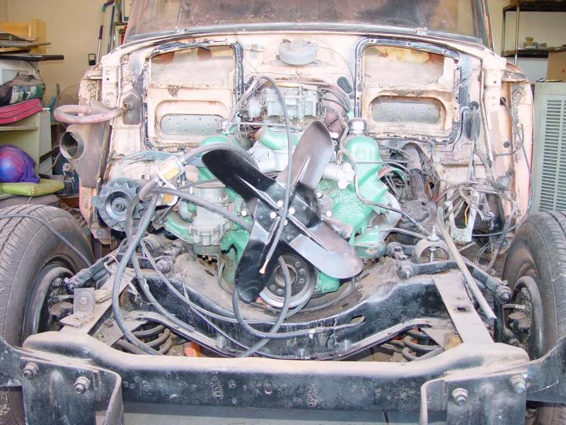

Hey Bard, I think you meant that nailhead comment for me, not Rightlane. Not to hijack his thread (by the way, congrats on winning the bid rightlane, I cant wait to see the build!).
I am still debating whether to use the nailhead. I originally was going to, then it pissed me off, and I was going to swap it for the LT1. Now I think I am going to give the nailhead one more chance before I swap it.
Unfortunatly, if I do swap it, I will probably part the engine. A 56 nailhead is worth a LOT more as parts than as a lump.
I had previously cleaned up the engine and made it pretty (didnt do a tear down of it, but did look around the top and bottom end, and replaced the fuel pump, waterpump and rebuilt the carb). When I fired it up, it ran but when it warmed up, it let me know the freeze plugs were rusted out. So that ticked me off (you can understand the anger I felt, that a 55 yr old freeze plug would have the nerve to rust). So I put it away for a year or two while I finished my truck.
I actually got back to work on it this week, the engine is coming out tomorrow, and I will see where I go from there.
