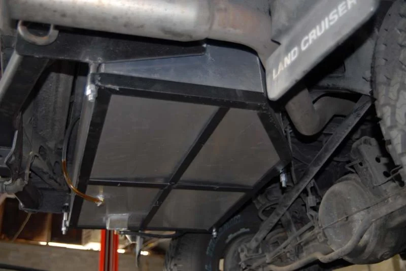

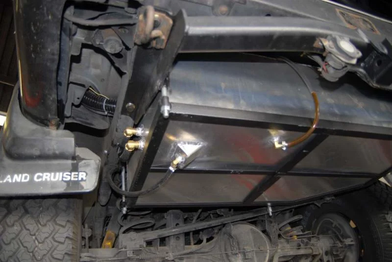

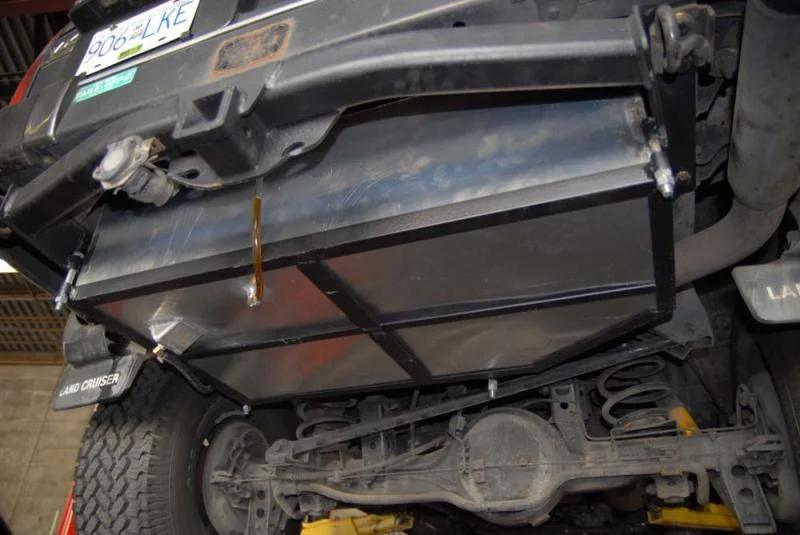

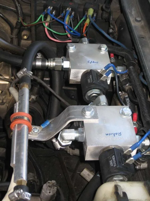

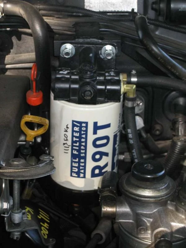

Pics of my HDJ81 WVO install.
Well I finally got my butt in gear and did my WVO install. Includes a heated 135 liter (~35 gallons) aluminum tank cut to fit with about 3/4" clearance to each frame rail as well as the exhaust. Has two hydraforce valves so I won't get any contamination and the dependability of high pressure/temperature hydraulic valves (not the cheapo 6 port pollack things).
I also put in a sight line to ensure I don't overfill and an easy to use marine filler that even says 'waste'

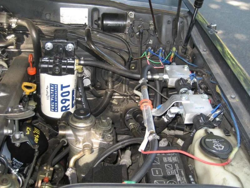

underhood...

Can't post any more pics of the switches, filler and fuel level gauge...

Your work is beautiful but ....
Those bungs on the bottom of the tank, as well as how low the tank hangs, scares me.
Do you wheel this?

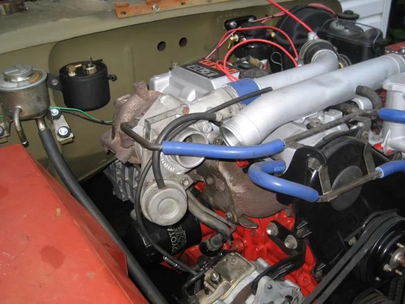

Don't wheel this....but I wheel this New project!!!!!! Willys time - BB.BC4x4.COM
'47 jeep willys
- frame off cut/sectioned frame+body
- toyota 2.4l 2l-t
- dual cases with 4.7 gears
- locked fr/rr
- DOM cage
the fj80 is my daily driver
