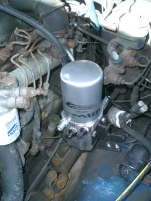

hey folks.
i finished my wvo conversion on my bj60 about a week ago. its been up and running fine up until about yesterday. i'll be driving along fine and out of nowhere i lose power and the engine dies. i gotta scramble to get the engine back on and switch to diesel immediately. sometimes I can pump the gas pedal and the rpms will go back up but it mostly just dies. this has happened about 5 times in the last 2 days.
I bought a dieselcraft centrifuge for filtering and have been doing hot pan tests (but i have read the centrifuge takes care of any water in the wvo anyways...) so I dont think it is a problem with the wvo itself. probably something going on in the fuel lines?
anyways. just wondering if this sounds familiar to anyone out there!

I am a little confused, you said the filters are mounted upside down, but the picture shows them right side up? At any rate, could you fill them via the bleeder on the bottom of the filter? I am imagining something with some thin hose plugged onto the filter and a little funnel on the other? A MityVac would be perfect! I like to fill my filters with diesel or a diesel cleaner, just to give it a little treat on startup.
You are confused because those are not my filters. As I said "I have seen it done like this to prime spin on filters on a boat" then showed a picture of it.
The issue I would have with pushing oil back in through the drain, is the drain is currently open to the environment, and likely has a lot of dirt & crap in it. I would prefer not to push that back into the filter - though I suppose I could rig a "clean" drain.
The filter on my truck is the other way up...
Mine:
And is this the way you would configure a 6 port valve? (it's in my WVO build up thread, listed in my signature)
