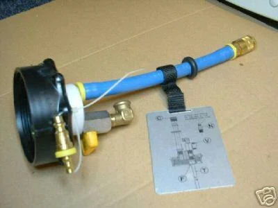

Will this work for my WVO fuel tank system?
anyone running their WVO from a Scepter plastic military fuel can with this adapter NSN 7240-21-911-8834? I am hoping this MFC (military fuel can) adapter cap will work? here is another one, NSN 7240-21-912-8834 Adapter Multi-Feed (gravity or suction) Assembly Unit. I am trying to find out if it is used for diesel as well? It says gravity fed, does anyone see any problems with if it is used with WVO system on my BJ42 being fed by my fuel pump? any suggestions?

Scepter emailed me today and confirmed that this adapter is gravity feed only? I am not really sure if it is going to work for what I am trying to do then? WIll this be a problem since my fuel pump is going to pulling fuel from it? They also sell 2 other adapeters, 1 is for suction and the other is both but that one is $225.

depending on how it is made on the inside you should be able to hookup a pump to it, but w/o putting my hands on it i would not know for sure.

For that kind of money an outboard motor fuel tank would be cheaper and easier to adapt. Use it for the purge/start fuel and put the VO in the main tank.

You could use that adapter and carry the jerry can on its side so it is gravity fed.

I would guess they are gravity feed only because there isn't a hose going down to the bottom of the tank, seems like that should be easy to add so you could hook it up to a pump. Cool idea.

I have 4 new Diesel Scepter cans, Scepeter also makes an adapter that is for both gravity and suction but is like $250? hoping to make this one work somehow. Mine is the pic on left, the dual purpose one that is $250 is on the right.
