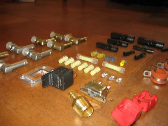

So here I am about to undertake the installation of my very own veggie conversion kit. I'm in Santiago Chile, staying at a friend's downtown apartment, parked illegally in a residential space... so far the foreign plates have warded off tickets. Yet another rediculous undertaking by me... anyway, wish me luck! Details on the install below.
The kit I chose is from Plantdrive.ca. I initially chose this kit mainly based around their coolant-heated fuel filter... I was attracted to it because a fellow mudder in another thread in this section used it, and when I read more I really liked the look of it. The design is very nice, offers water separation (essential for me as I'm on the go and may end up with more water in my fuel than the average user), it has some great features, fits my engine bay, everything looked right including the price, and of course it's made in Canada!
The fact that I'm in South America necessitated minimal shipping size and weight, and Plantdrive doesn't actually offer a specific kit for the BJ60 anyway, so they very kindly and put together a "custom" kit. Shipping of a fuel tank and fuel/coolant lines would be unnecessary and expensive, additionally the BJ60's fuel system design means there is no need for a return line or extra 3-way valve if not desired. Thus what I have is the VegMax filter described above, the VegTherm inline 12V fuel line heater, the Hydraforce 3-port valve, and all the fittings and such to put it all together. The Plantdrive people were even kind enough to include an extra filter element and some clear hose that will make the installation look oh so much more futuristic and awesome.
Wow that aluminum looks beautiful!

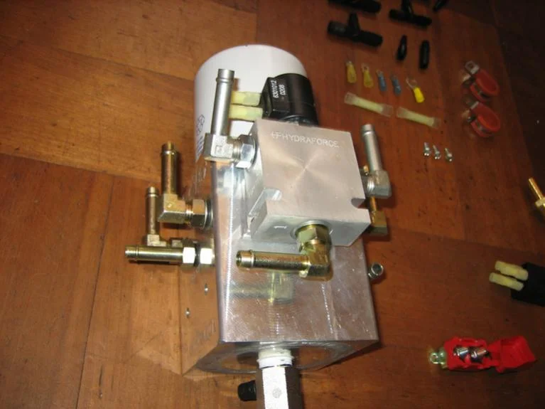

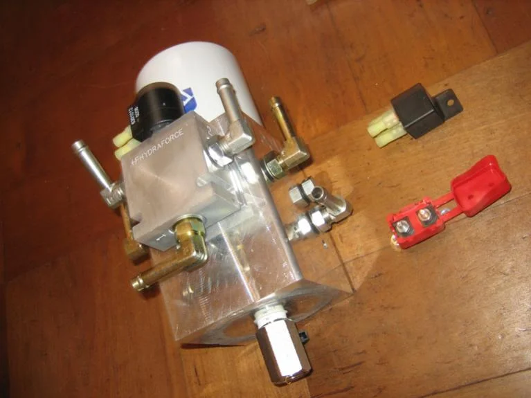

Now, of course since this is technically just a collection of parts that I've ordered and not an actual kit, I don't have an instruction manual. No problem, it's a simple system and I know how it works right!
Well at first I must admit I felt a little out of my depth when I looked at the pile of parts sitting in front of me... however I pulled myself together and began to organize them, using skills honed from years of organizing lego pieces...
With everything making a bit more sense, I began to assemble the pieces that I could put together in the living room, sans truck and fuel lines.

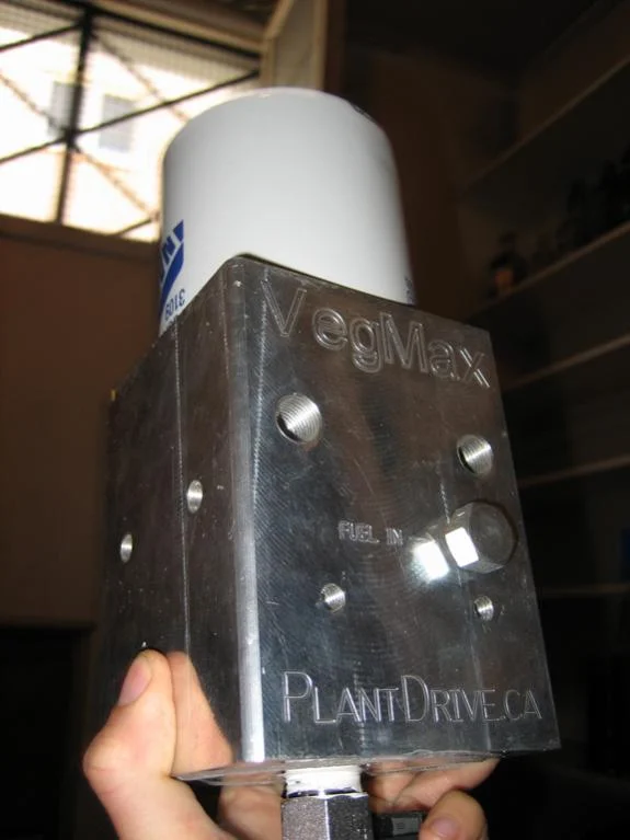

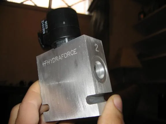

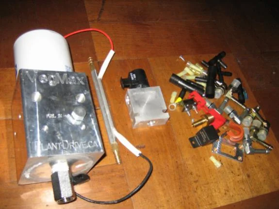

Here you can see the result of me fiddling with things and sort of sticking it all roughly together. Now I'm at the point of needing to go out and actually buy the fuel line! Also, I'm going to have to figure out some sort of mounting option (ie. find a welding shop and have a bracket made). Let's hope I do a good job!
I think for veggie fuel storage for now I am going to follow some good advice and simply store it in a jerry can inside the vehicle and run a fuel line through the firewall. The reason for this is I am headed for some very cold weather, and this seems to me the best and simplest way to keep the stored fuel warm. Additionally, it's just the simplest way... I already have jerry cans and holes in my firewall, there are likely no regulations making this illegal where I am, and I realistically am not likely going to be able to fab/scrounge/attach an extra fuel tank and all that's involved in my current situation.
