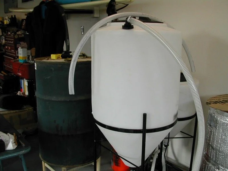

Made my first batch of Biodiesel
Pic 1 shows the whole system. The white tank on the right is my collection tank, the silver one is the pre-heat tank. I heated approximately 23 gallons and pumped it into the white tank on the left. That is where the magic happens. I mix in my Methanol/lye mixture and circulate out of the tank from the bottom and back into the tank from the top for about two hours.

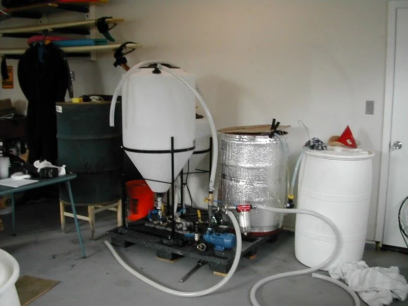

Pic 2 you can see the smaller tank in the back, that is where I mix the Methanol and Lye, it than drains into the flow of the circulating oil from the big tank. After circulating I let it stand for about four hours, than drain off the Glyceren from the bottom. You cant see in the pictures, but the mixing tank has a water jacket on top. I plugged my garden hose into to it and pumped about five gallons of water at a fine mist. Let the water settel to the bottom and drain and repeat until the water is clear. That is where I am at right now. As soon as I am done "Washing", I will pump it into a drying tank. Once dry, I hope to be burnning it. I will post more info on my final product and how my ride is liking it.

Nice compact set-up. What happens to the methanol fumes?

Cool! Constructed yourself? $$? How long to produce a batch and what is the final quantity?
Good on ya!

mac,
No I bought the system, I didn't want to try to fab one up myself, even though they are pretty simplistic. I paid $1300, that included shipping. I know that seems high, but I figure I will break even in about six months or so. Diesel is, best price I found 3.57 a Gal. It cost me around 1.50 a Gal, thats just a guesstimate. It's taken me two days to get to the drying stage. one hour to heat the oil, two hours mixing the oil. Let the oil sit over night. Washing took a total of 10 hours, that is not hands on time. Most of the time is waiting for it to do it's thing.

You have one advantgage that perhaps alot of people may not have and that is a warm garage to do this. Just a few warnings though. Use a splash shild and bib when mixing the methoxide it can be absobed into the skin and cause blindness and also no smoking in the area. I would be as a safety percaution put all this in a metal shilded enclosure in the case there is a fire not that it would happen.
Also, try using the glycerin on auto parts. The glycerin is supper slippery and works great as a soap and should make heavy oil grime slip right off the auto parts.
I did my first batch about seven years ago but first heard about it 10 years ago when almost no one in the states herd of it. Good luck in using it. It will drop your emissions to some really amazing low numbers when you have to take it in for your yearly test and also, dont use it if the temp out side drops to freezing

Yes I am getting my oil from a local restaurant for free. It's almost 100% return on your oil, All the Methanol turns into Glycerin, well most of it.

Things are going good so far. I am burning approximately 20% bio to 80% diesel right now, its a little cold out. I have 50 more gallons ready to convert, just waiting on some methanol to come in, I had to order it and with the Holidays and all things are a Little slow as far as shipping goes.
The exhaust definitely smells different, not like fries just smells like hot oil. Have not noticed a drop in power, its a 2b motor not a lot of power to begin with.

Up to about 25% BD or VO, one will usually get improved economy or a perceived increase in power which can eat the economy gain. Up to 25% percent the VO or BD helps the diesel burn more completely. Above 25% the economy drops with added VO or BD.
