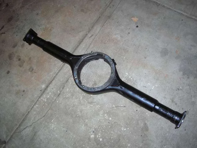

Axle housing is already done, Minitruck Outers, Cruiser Center Section..
55" WTW same as stock FJ40
i Still need to Finish the Disk Brakes, and figure out a 3rd Member
i have a used 4:11 Fine Spline Gearset i may toss into my Welded 3rd for now
