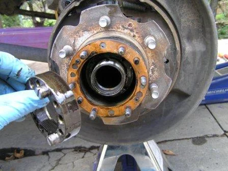

top: behind the lock ring is the thrust washer with the notch that sits in the groove on the top of the spindle.

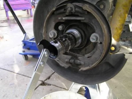

middle: popping out the axle oil seal that sits inside of the spindle.

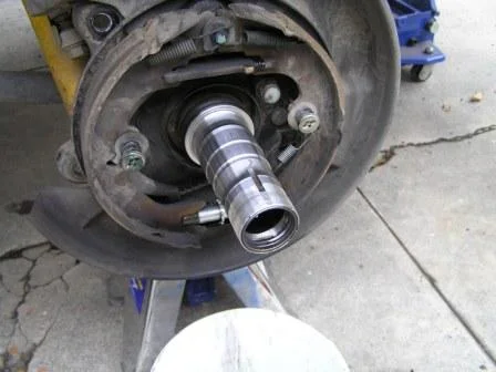

bottom: spindle cleaned and ready to start rebuild
