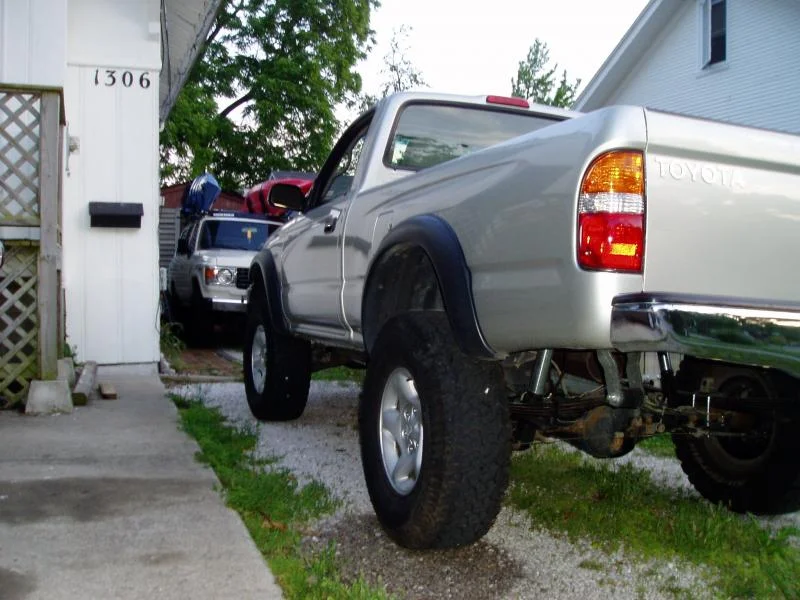

i run 285 75 16s on my 4.30 geared 2.7 and have no problems with top end speeds.

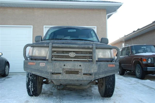

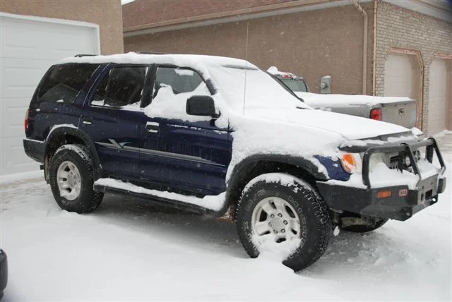

Attached picture of my 96 runner with the 235/85R16's

Quote:
Originally Posted by PACMAN View Post
All that snow in those pictures in Medicine Hat? - My wife and I recently camped out in the Valley of the Gods for a couple of nights. Beautiful.
Thanks-
Yes 15 inch tire options are likely shrinking as time goes on.
Snow pictures are from last winter here in "The Hat". We seem to be getting more of that stuff here in the recent years. We often had brown Christmas's here before.
Thanks for the Valley of the Gods comment.. looks like a place to put on the list!
I'm not sure what ratios your Taco has but my 2.7 runner sure worked to spin those Michelin's in the pictures. It was great off road and in snow/mud because of the narrow tire but highway hills with a headwind required patience some days.

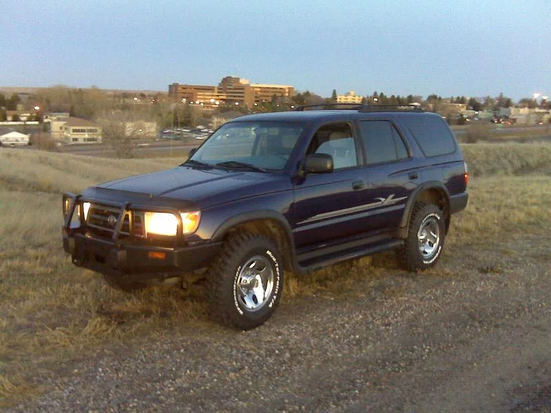

Pacman here is a couple pics of what the LT245/75R16's look like mounted on
16 X 7 2003 Taco chromed steel rims on my 96 Runner.

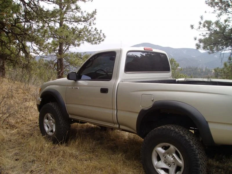

downey shackles , deaver leafs & 5100 bilsteins for the rear and OME 880 with 5100 bilsteins adjusted at max for the front.
