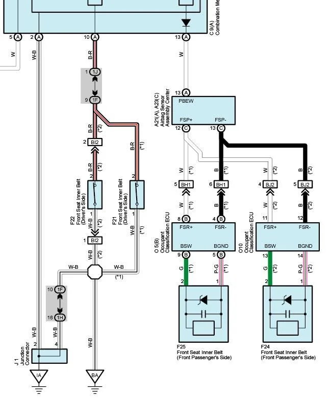

There is a connector at each inner seat belt buckle.
Name:  Taco Seat Belt.jpg
On the driver's seat, it would be a simple matter of disconnecting and jumpering the connector. The passenger side looks more complicated with a diode and possibly a solid state electronic sensor.

TD,
Thanks! Great info. The passenger side is definitely more complicated. I've activated the occupant sensor just by putting a moderately heavy bag on the seat. It moved at a stop light and the damn dash started chirping and flashing. Maybe I can find an EE to help me! With my luck I'd activate the airbags.
