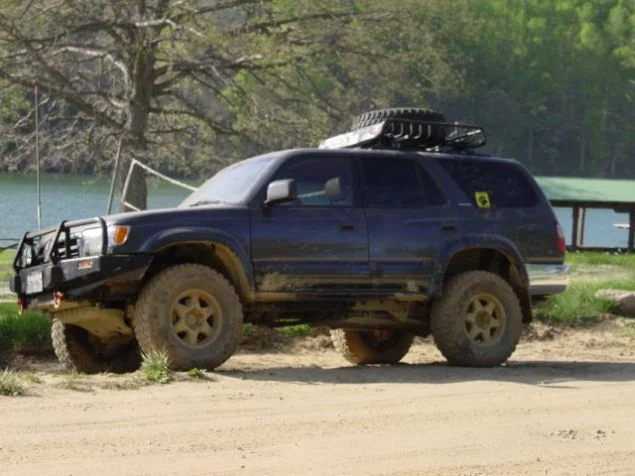

I installed OME front and rear, and then put in 1" Daystar Spacers in the front, because it was sagging, ARB bumper weight didn't help. Not sure I would recommend my setup, but is sits level now.
