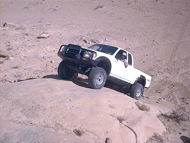

I run the TJM in the front and approach angle ( like the ARB) is better than stock. I have Downey coil overs in the front and OME springs in the back, they have served me well. Spacer will do you no good if your fronts have 110K on them. The ride will suffer, better to replace the shocks.
I have the Xenon flares on my '98 and I still love them. I know the company says they will not fit. Back in the day I had a conversation with the owner and he swore up and down that they would not fit even after I sent him a picture with them on the truck. All I can say is that he was very argumentative and I chalked it up to him being a know-it-all moron who wouldn't listen.
Older Pic but you get the idea.
