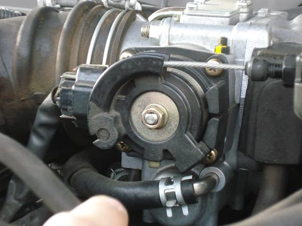

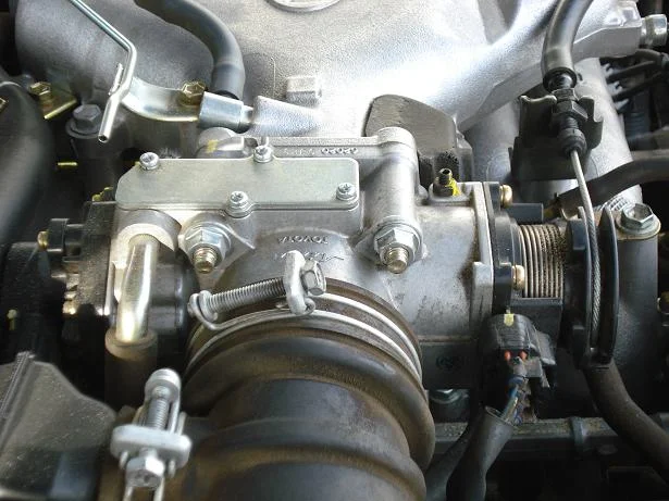

Well.... I took a look at it, but I think they switched to a fly-by-wire system at some point. The only cable is the throttle cable, which I did adjust a little, but it wasn't "loose" by any means... There's not cruise "actuator" like I'm used to seeing, no kickdown cable... In the second pic the left side of the intake has a lot of stuff going on, I'm thinking this could be all the cruise stuff in there together... Who knows.... Anyone know of an 01 FSM online?
