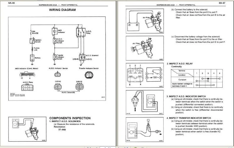

I am not exactly sure what your problem is from your description, but I hope these will help.
Dan

I would check for you, but I took the ADD out of my rig....
I'll take a look through the manual tho...
Try the tests above. They should be able to isolate the problem.

Turns out one of the vac solenoids is bad, $400 for new from Toyota.
