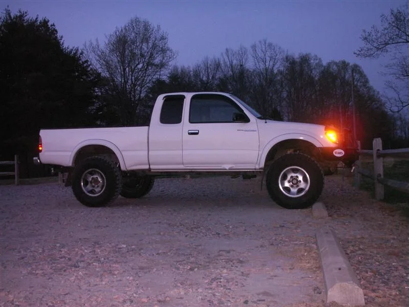

been through this before too. the wheels will fit no problem, but the 285's will require a lift. you can go cheap $2-300 for a spacker and add a leaf or up to 2k on coilovers and custom leaf packs. Id recomend the Old Man Emu kit if your not going to run arb w/ winch. If you are the OME struts cant handle the weight over time. Its like $800 or so. Heres a pic of my 99 on 285 mtr's on 80 series wheels, specs in my sig line. the 33's shouldnt hurt you power wise too much, esp if you got a 5 speed. Ive got the 2.7 w/ a 5 spd plus the luxury of toyotas smallest gear ring ever 3.73 and its still very tolerable as a DD.

I have 32x11.5x15 BFG ATs on my 96 Tacoma with only a 1/2" leveling spacer in the front. I also have an ARB Bullbar with a hilift jack mounted to it, and very old saggy regular Tacoma (Not TRD progressive rate) springs, and have minimal rubbing. Any rubbing that you would have would be at full lock on the pinch weld in the rear of the wheelwell. You could do the "pinch weld mod" to take care of that. If you have 4.10 gears you'd be fine with those tires. 3.58's would be a stretch, although I ran with them for years with my ATs I'm not trying to debate here, and every truck is different, but 31.7" tires should easily fit with minimal lift.

FYI, a 32x11.5R15 is equivalent to a 265/75R16 (~31.7"). The 285/75R16 is 33". There is no 285/70R16 in the Revo if that was confusing anyone. Of course all of this is now a moot point as he indicated it's not feasible. But I still think these wheels look great on tacomas & 4rnrs, so I still vote for Mars to keep it in consideration (we need a devil's advocate smiley).
