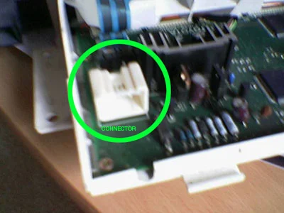

Dariuz,
Hopefully this will help. This illustration shows the cable colors if you look at the dome from the back. I've copied the colors from the cable I got from Toyota (see attachment)

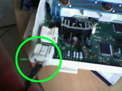

This is the cable and connector in the same position as I used to create the top illustration showing the cable colors:
